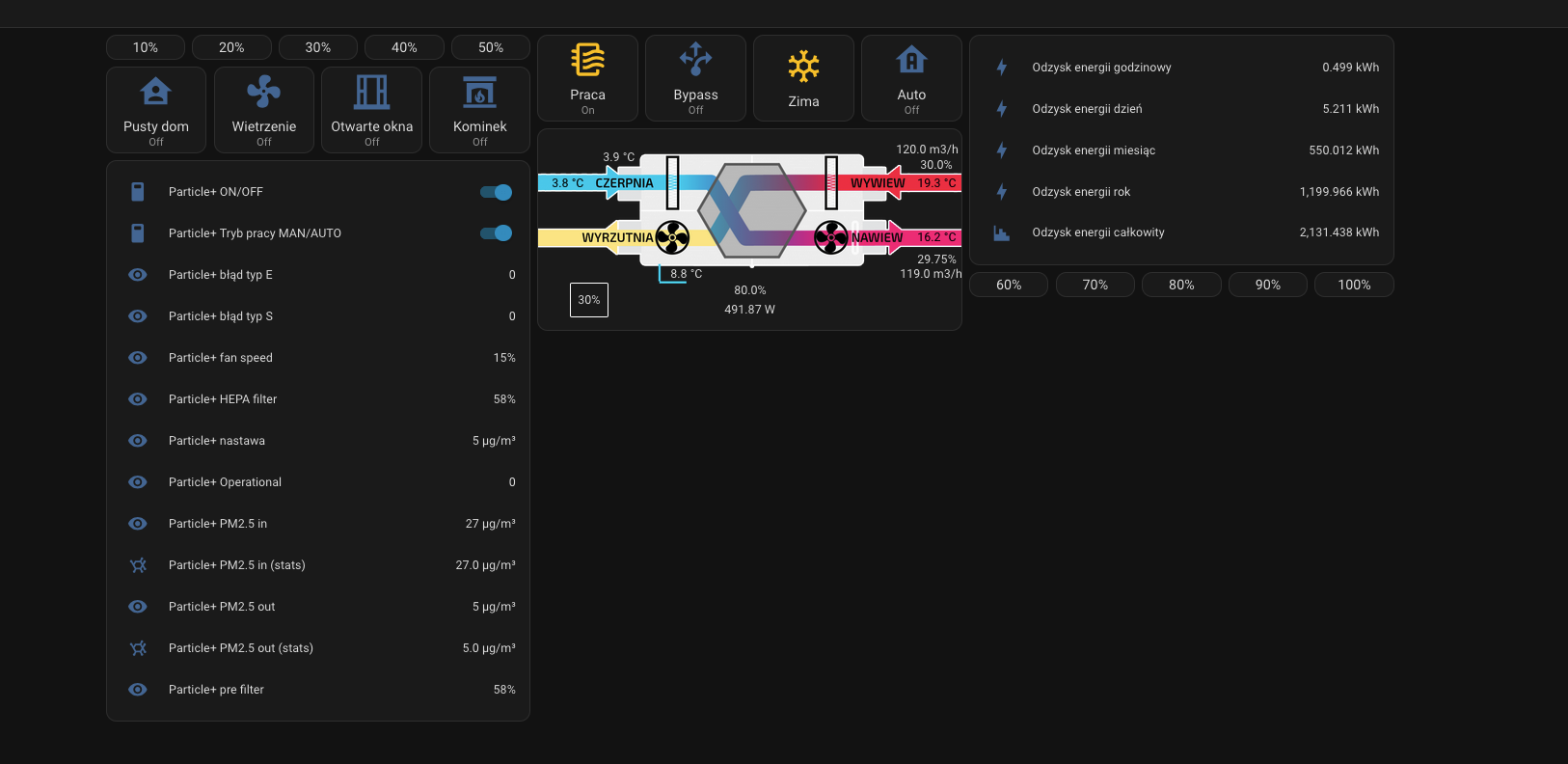

ps dalbys rade wyslac mi konfig twojego yamla rowniez z dashboardem? oczywiscie sensitive dane wyczysc, typu IP/port
Proszę bardzo:
type: vertical-stack
cards:
  - type: horizontal-stack
    cards:
      - type: button
        tap_action:
          action: toggle
        entity: switch.rekuperator_on_off
        show_state: true
        icon: mdi:air-filter
        show_name: true
        show_icon: true
      - show_name: true
        show_icon: true
        type: button
        tap_action:
          action: toggle
        entity: binary_sensor.rekuperator_silownik_bypassu
        show_state: true
        icon: mdi:arrow-decision
      - type: conditional
        conditions:
          - entity: switch.rekuperator_zima
            state: "on"
        card:
          type: button
          tap_action:
            action: toggle
          icon: mdi:snowflake
      - type: conditional
        conditions:
            state: "off"
        card:
          type: button
          tap_action:
            action: toggle
          icon: mdi:sun-snowflake
      - show_name: true
        show_icon: true
        type: button
        tap_action:
          action: toggle
        entity: switch.rekuperator_mode
        show_state: true
        icon: mdi:home-floor-a
      - type: button
        tap_action:
          action: toggle
        entity: switch.particle_on_off
        show_state: true
        show_name: true
        show_icon: true
    cards:
      - type: custom:button-card
        tap_action:
          action: call-service
          service: modbus.write_register
          service_data:
            address: 54
            unit: 30
            value: 1
            hub: particle
        styles:
          name:
            - color: lightgreen
        target: {}
        show_icon: false
        tap_action:
          service_data:
            address: 54
            unit: 30
            value: 2
            hub: particle
        styles:
          name:
            - color: lightgreen
        target: {}
        show_icon: false
        tap_action:
          service_data:
            address: 54
            unit: 30
            value: 3
            hub: particle
        styles:
          name:
            - color: lightgreen
        target: {}
        show_icon: false
        tap_action:
          service_data:
            address: 54
            unit: 30
            value: 4
            hub: particle
        styles:
          name:
            - color: lightgreen
        target: {}
        show_icon: false
        tap_action:
          service_data:
            address: 54
            unit: 30
            value: 5
            hub: particle
        styles:
          name:
            - color: lightgreen
        target: {}
        show_icon: false
    cards:
      - type: button
        tap_action:
          service_data:
            address: 4210
            unit: 10
            value: 60
            hub: rekuperator
        target: {}
        show_icon: false
      - type: button
        tap_action:
          service_data:
            address: 4210
            unit: 10
            value: 70
            hub: rekuperator
        target: {}
        show_icon: false
      - type: button
        tap_action:
          service_data:
            address: 4210
            unit: 10
            value: 80
            hub: rekuperator
        target: {}
        show_icon: false
      - type: button
        tap_action:
          service_data:
            address: 4210
            unit: 10
            value: 90
            hub: rekuperator
        target: {}
        show_icon: false
      - type: button
        tap_action:
          service_data:
            address: 4210
            unit: 10
            value: 100
            hub: rekuperator
        target: {}
        show_icon: false
  - type: picture-elements
    elements:
      - type: state-label
        entity: sensor.rekuperator_temperatura_czerpnia
        style:
          top: 27%
          left: 10%
          color: "#00CCFF"
          font-size: 120%
          font-weight: bold
      - type: state-label
        entity: sensor.rekuperator_temperatura_za_fpx
        prefix: "FPX: "
        style:
          top: 16%
          left: 0%
          color: "#00CCFF"
          font-weight: bold
          transform: rotate(0deg)
      - type: state-label
        entity: sensor.rekuperator_temperatura_nawiew
        style:
          top: 68%
          left: 39%
          color: lightblue
          font-size: 120%
          font-weight: bold
      - type: state-label
        entity: sensor.rekuperator_strumien_nawiew
        style:
          top: 64%
          left: 53%
          color: lightblue
          font-size: 80%
          font-weight: bold
      - type: state-label
        entity: sensor.rekuperator_wysterowanie_nawiew
        style:
          top: 60%
          left: 52%
          color: lightblue
          font-size: 80%
          font-weight: bold
      - type: state-label
        entity: sensor.rekuperator_temperatura_wywiew
        style:
          top: 27%
          left: 39%
          color: red
          font-size: 120%
          font-weight: bold
      - type: state-label
        entity: sensor.rekuperator_strumien_wywiew
        style:
          top: 32%
          left: 53%
          color: red
          font-size: 80%
          font-weight: bold
      - type: state-label
        entity: sensor.rekuperator_wysterowanie_wywiew
        style:
          top: 36%
          left: 52%
          color: red
          font-size: 80%
          font-weight: bold
      - type: state-label
        entity: sensor.rekuperator_sprawnosc
        prefix: "Sprawność: "
        style:
          top: 63%
          left: 24%
          color: green
          font-weight: bold
      - type: state-label
        entity: sensor.rekuperator_temperatura_pcb
        prefix: "Temperatura strych: "
        style:
          top: 10%
          left: 50%
          color: grey
          font-size: 100%
          font-weight: bold
      - type: state-label
        entity: sensor.blank_blank
        prefix: "Zużycie AirPack4 + Particle+: "
        style:
          top: 75%
          left: 75%
          color: red
          font-size: 100%
          font-weight: bold
      - type: state-label
        entity: sensor.rekuperator_moc
        prefix: "chwilowe: "
        style:
          top: 80%
          left: 80%
          color: red
          font-size: 100%
          font-weight: bold
      - type: state-label
        entity: sensor.rekuperator_zuzycie_dzienne
        prefix: "dzienne: "
        style:
          top: 85%
          left: 80%
          color: red
          font-size: 100%
          font-weight: bold
      - type: state-label
        entity: sensor.rekuperator_zuzycie_miesiac
        prefix: "miesięczne: "
        style:
          top: 90%
          left: 80%
          color: red
          font-size: 100%
          font-weight: bold
      - type: state-label
        entity: sensor.rekuperator_zuzycie_roczne
        prefix: "roczne: "
        style:
          top: 95%
          left: 80%
          color: red
          font-size: 100%
          font-weight: bold
      - type: state-label
        prefix: "Odzysk energii: "
        style:
          top: 75%
          left: 22%
          color: green
          font-weight: bold
      - type: state-label
        entity: sensor.rekuperator_odzyskana_moc
        prefix: "chwilowy: "
        style:
          top: 80%
          left: 22%
          color: green
          font-weight: bold
      - type: state-label
        entity: sensor.rekuperator_odzyskana_moc_dzien
        prefix: "dzienny: "
        style:
          top: 85%
          left: 22%
          color: green
          font-weight: bold
      - type: state-label
        entity: sensor.rekuperator_odzyskana_moc_miesiac
        prefix: "miesięczny: "
        style:
          top: 90%
          left: 22%
          color: green
          font-weight: bold
      - type: state-label
        entity: sensor.odyskana_energia_rocznie
        prefix: "roczny: "
        style:
          top: 95%
          left: 22%
          color: green
          font-weight: bold
      - type: state-label
        entity: sensor.rekuperator_speedmanual
        style:
          top: 10%
          left: 9%
          border: 3px solid gray
          border-radius: 25%
          color: white
      - type: state-label
        entity: sensor.outdoor_temperature
        prefix: "Temperatura zewnętrzna: "
        style:
          top: 4%
          left: 50%
          color: white
          font-size: 100%
          font-weight: bold
      - type: state-label
        entity: sensor.zuzycie_filtra_nawiewnego
        style:
          top: 38%
          left: 11%
          color: black
          font-size: 120%
          font-weight: bold
      - type: state-label
        entity: sensor.zuzycie_filtra_wywiewnego
        style:
          top: 38%
          left: 41%
          color: black
          font-size: 120%
          font-weight: bold
      - type: state-label
        entity: sensor.particle_pm2_5_in
        style:
          top: 40%
          left: 77%
          color: orange
          font-size: 100%
          font-weight: bold
      - type: state-label
        entity: sensor.pm_2_5_max_24h
        prefix: "PM 2,5 (max 24h): "
        style:
          top: 25%
          left: 80%
          color: orange
          font-size: 80%
          font-weight: bold
      - type: state-label
        entity: sensor.particle_pm2_5_out
        style:
          top: 46%
          left: 86%
          color: lightgreen
          font-size: 100%
          font-weight: bold
      - type: state-label
        entity: sensor.pm_2_5_max_24h_filtr
        style:
          top: 30%
          left: 80%
          color: lightgreen
          font-size: 80%
          font-weight: bold
      - type: state-label
        entity: sensor.particle_fan_speed
        style:
          top: 55%
          left: 82%
          color: white
          font-size: 120%
          font-weight: bold
      - type: state-label
        entity: sensor.particle_pre_filter
        style:
          top: 63%
          left: 75%
          color: white
          font-size: 100%
          font-weight: bold
      - type: state-label
        entity: sensor.particle_hepa_filter
        style:
          top: 63%
          left: 88%
          color: white
          font-size: 100%
          font-weight: bold
      - type: state-label
        prefix: ePM1
        style:
          top: 69%
          left: 74%
          font-weight: bold
          font-size: 80%
      - type: state-label
        prefix: H13
        style:
          top: 69%
          left: 88%
          font-weight: bold
          font-size: 80%
      - type: state-label
        entity: sensor.particle_nastawa
        style:
          top: 15%
          left: 90%
          border-radius: 25%
          color: lightgreen
      - type: image
        state_image:
          "on": /local/ikony/Bypass.png
          "off": /local/ikony/reku_empty.png
        style:
          top: 50%
          left: 23%
          width: 25%
      - type: image
        entity: sensor.rekuperator_fpx_flaga
        state_image:
          "0": /local/ikony/reku_empty.png
          "1": /local/ikony/reku_fpx.png
        style:
          top: 27%
          left: 25%
          width: 6%
      - type: image
        entity: sensor.rekuperator_fpx_tryb
        state_image:
          "1": /local/ikony/FPX1.png
          "2": /local/ikony/FPX2.png
        style:
          top: 37%
          left: 20%
          width: 15%
      - type: image
        entity: sensor.rekuperator_alarm
        state_image:
          "1": /local/ikony/reku_alarm.png
        style:
          top: 57%
          left: 24%
          width: 40%
      - type: image
        entity: sensor.rekuperator_error
        state_image:
        style:
          top: 57%
          left: 24%
          width: 40%
      - type: image
        entity: sensor.rekuperator_awaria_cf_nawiewu
        state_image:
        style:
          top: 57%
          left: 24%
          width: 40%
      - type: image
        entity: sensor.rekuperator_awaria_cf_wywiewu
        state_image:
        style:
          top: 57%
          left: 24%
          width: 40%
      - type: image
        entity: sensor.rekuperator_awaria_wentylatora_nawiewu
        state_image:
        style:
          top: 57%
          left: 24%
          width: 40%
      - type: image
        entity: sensor.rekuperator_awaria_wentylatora_wywiewu
        state_image:
        style:
          top: 57%
          left: 24%
          width: 40%
      - type: image
        entity: sensor.rekuperator_fpx_zabezpieczenie_termiczne
        state_image:
        style:
          top: 57%
          left: 24%
          width: 40%
      - type: image
        entity: sensor.rekuperator_wymiana_filtrow
        state_image:
          "1": /local/ikony/filtry.png
        style:
          top: 37%
          left: 24%
          width: 40%
    image: /local/ikony/airpackparticle2.png
    cards:
      - type: button
        tap_action:
          service_data:
            address: 4210
            unit: 10
            value: 10
            hub: rekuperator
        target: {}
        show_icon: false
      - type: button
        tap_action:
          service_data:
            address: 4210
            unit: 10
            value: 20
            hub: rekuperator
        target: {}
        show_icon: false
      - type: button
        tap_action:
          service_data:
            address: 4210
            unit: 10
            value: 30
            hub: rekuperator
        target: {}
        show_icon: false
      - type: button
        tap_action:
          service_data:
            address: 4210
            unit: 10
            value: 40
            hub: rekuperator
        target: {}
        show_icon: false
      - type: button
        tap_action:
          service_data:
            address: 4210
            unit: 10
            value: 50
            hub: rekuperator
        target: {}
        show_icon: false
    cards:
      - type: button
        tap_action:
          action: toggle
        entity: switch.rekuperator_pusty_dom
        icon: mdi:home-account
        show_state: true
      - type: button
        tap_action:
          action: toggle
        entity: switch.rekuperator_wietrzenie
        show_state: true
        icon: mdi:fan
      - type: button
        tap_action:
          action: toggle
        entity: switch.rekuperator_okna
        show_state: true
        icon: mdi:window-open-variant
      - show_name: true
        show_icon: true
        type: button
        tap_action:
          action: toggle
        entity: switch.rekuperator_kominek
        show_state: true
        icon: mdi:fireplace
title: THESSLAGREEN - AirPack4 Enthalpy 500h Particle+
Kilka rzeczy trzeba poprawić, ale nie mam chwilowo czasu.
Dzieki wielkie, podeslesz jeszcze konfig od modbusa? W sumie chyba najbardziej o to mi sie tez rozchodzi czy nie mam tam jakiegos strzala literowego :pray: ale to by pewnie walidator krzyczal
3 dni temu wysyłałem - jest kilka odpowiedzi wyżej.
dzieki, skopiowalem Twój konfig modbusa wywalilem poprzedni co mialem z reku i widze ze w koncu zaczelo mi to banglac:
dzieki wszystkim za pomoc, problem byl miedzy fotelem a monitorem, jak to mawiają :smiley:
