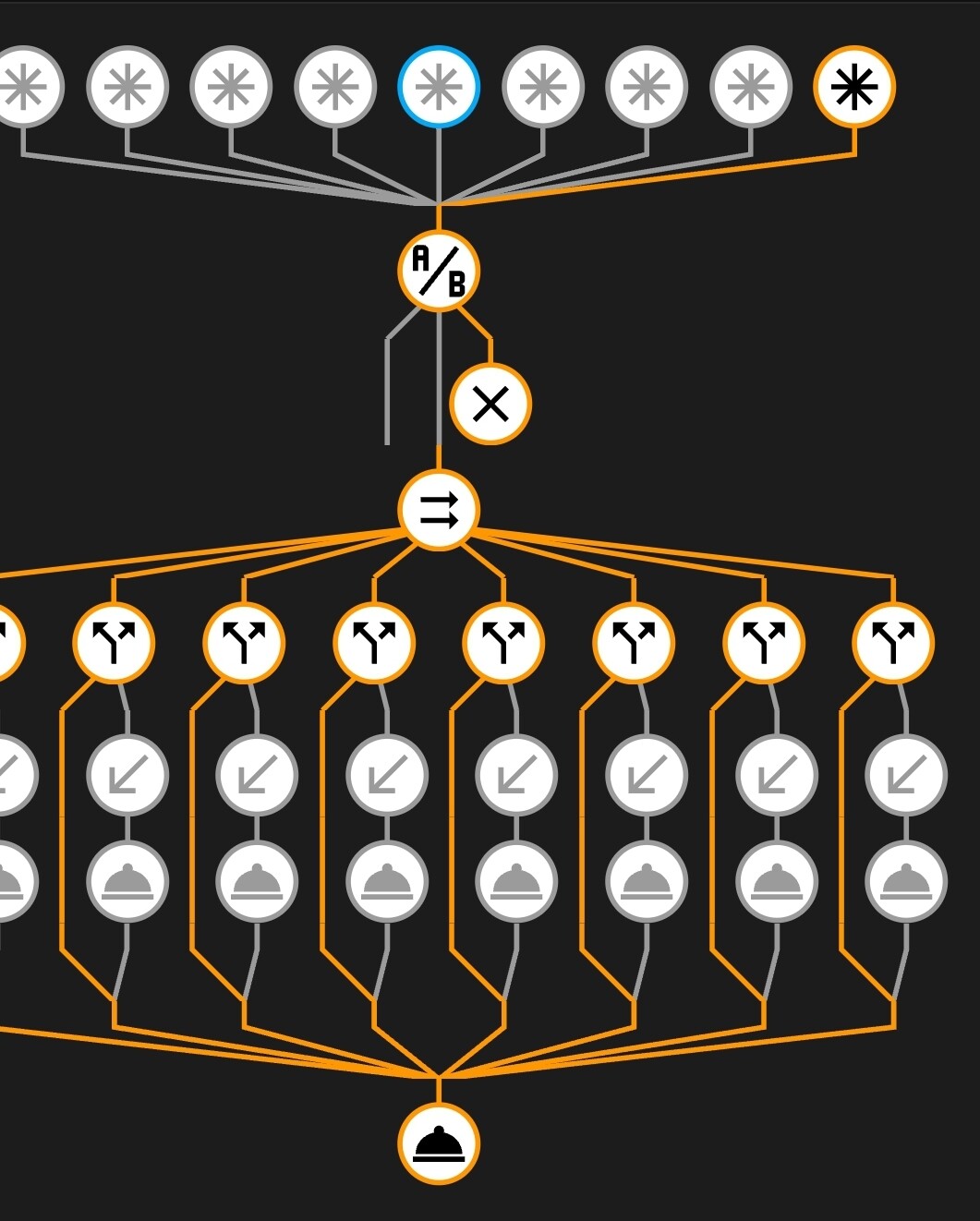

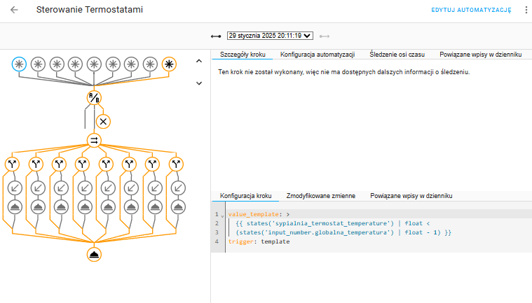

alias: Sterowanie Termostatami
description: >-
  Automatyczne sterowanie grzejnikami z uwzględnieniem histerezy ±1°C i
  wyłączeniem termostatów, gdy temperatura przekroczy zadaną
trigger:
  - value_template: >
      {{ states('sensor.kuchnia_temperatura') | float < (states('input_number.globalna_temperatura') | float - 1) }}
    trigger: template
  - value_template: >
      {{ states('sensor.lazienka_temperatura') | float < (states('input_number.globalna_temperatura') | float - 1) }}
    trigger: template
  - value_template: >
      {{ states('sensor.salon_temperatura') | float < (states('input_number.globalna_temperatura') | float - 1) }}
    trigger: template
  - value_template: >
      {{ states('sensor.sypialnia_temperatura') | float < (states('input_number.globalna_temperatura') | float - 1) }}
    trigger: template
  - value_template: >
      {{ states('sensor.kuchnia_temperatura') | float > (states('input_number.globalna_temperatura') | float + 1) }}
    trigger: template
  - value_template: >
      {{ states('sensor.lazienka_temperatura') | float > (states('input_number.globalna_temperatura') | float + 1) }}
    trigger: template
  - value_template: >
      {{ states('sensor.salon_temperatura') | float > (states('input_number.globalna_temperatura') | float + 1) }}
    trigger: template
  - value_template: >
      {{ states('sensor.sypialnia_temperatura') | float > (states('input_number.globalna_temperatura') | float + 1) }}
    trigger: template
condition:
  - condition: state
    entity_id: input_boolean.ogrzewanie_wlaczone
    state: "on"  # Automatyzacja działa tylko, gdy ogrzewanie jest włączone
action:
  - parallel:
      - if:
          - condition: template
            value_template: >
        then:
          - target:
              entity_id: climate.termostat_kuchnia
              hvac_mode: heat
            action: climate.set_hvac_mode
      - if:
            value_template: >
        then:
          - target:
              entity_id: climate.termostat_lazienka
              hvac_mode: heat
      - if:
            value_template: >
        then:
          - target:
              entity_id:
                - climate.termostat_salon
                - climate.termostat_salon2
              hvac_mode: heat
      - if:
            value_template: >
        then:
          - target:
              entity_id: climate.termostat_sypialnia
              hvac_mode: heat
      - if:
            value_template: >
        then:
          - target:
              hvac_mode: "off"
      - if:
            value_template: >
        then:
          - target:

Niestety podstawiłem i coś nie działa, tak wygląda po podstawieniu
description: >-
triggers:
  - value_template: >
      {{ states('sypialnia_termostat_temperature') | float <
    trigger: template
  - value_template: >
      {{ states('salon_termostat_temperature') | float <
    trigger: template
  - value_template: >
      {{ states('kuchnia_termostat_temperature') | float <
    trigger: template
  - value_template: >
      {{ states('łazienka_termostat_temperature') | float <
    trigger: template
  - value_template: >
      {{ states('sypialnia_termostat_temperature') | float >
    trigger: template
  - value_template: >
      {{ states('salon_termostat_temperature') | float >
    trigger: template
  - value_template: >
      {{ states('kuchnia_termostat_temperature') | float >
    trigger: template
  - value_template: >
      {{ states('łazienka_termostat_temperature') | float >
    trigger: template
conditions:
  - condition: state
    entity_id: input_boolean.co
    state: "on"
    enabled: true
actions:
  - parallel:
      - if:
            value_template: >
        then:
          - target:
              entity_id: e96c14e96280327b13cda371cf81da1b
              hvac_mode: heat
      - if:
            value_template: >
        then:
          - target:
              entity_id: 2c59c3f20c1e56084f20bc663382a247
              hvac_mode: heat
      - if:
            value_template: >
        then:
          - target:
              entity_id:
                - f9369490ea66b9a54742e027595cfbf3
                - 0dd083d639da52a8ef406bcd73f7c27d
              hvac_mode: heat
      - if:
            value_template: >
        then:
          - target:
              hvac_mode: heat
      - if:
            value_template: >
        then:
          - target:
              entity_id: 09459c59b3f8ec37aba37b066ec45a4b
              hvac_mode: "off"
      - if:
            value_template: >
        then:
          - target:
              hvac_mode: "off"
      - if:
            value_template: >
        then:
          - target:
              entity_id:
              hvac_mode: "off"
      - if:
            value_template: >
        then:
          - target:
              hvac_mode: "off"
  - target:
      entity_id:
        - e96c14e96280327b13cda371cf81da1b
        - 09459c59b3f8ec37aba37b066ec45a4b
        - 2c59c3f20c1e56084f20bc663382a247
      hvac_mode: "off"
mode: parallel
max: 10
Problem chyba jest z termostatami
Racja ,nie zwracało wartości poprawnie.Wymień kawałek kodu od actions i sprawdz czy przechodzi poprawnie przez wyzwalacze, jeśli nie to w wyzwalaczach zamiast float zrób też float(0)
actions:
  - parallel:
      - if:
            value_template: >
              {{ states('sypialnia_termostat_temperature') | float(0) <
              (states('input_number.globalna_temperatura') | float(0) - 1) }}
        then:
          - target:
              hvac_mode: heat
      - if:
            value_template: >
              {{ states('łazienka_termostat_temperature') | float(0) <
        then:
          - target:
              hvac_mode: heat
      - if:
            value_template: >
              {{ states('salon_termostat_temperature') | float(0) <
        then:
          - target:
              entity_id:
              hvac_mode: heat
      - if:
            value_template: >
        then:
          - target:
              hvac_mode: heat
      - if:
            value_template: >
              {{ states('kuchnia_termostat_temperature') | float(0) >
              (states('input_number.globalna_temperatura') | float(0) + 1) }}
        then:
          - target:
              hvac_mode: "off"
      - if:
            value_template: >
              {{ states('łazienka_termostat_temperature') | float(0) >
        then:
          - target:
              hvac_mode: "off"
      - if:
            value_template: >
              {{ states('salon_termostat_temperature') | float(0) >
        then:
          - target:
              entity_id:
              hvac_mode: "off"
      - if:
            value_template: >
        then:
          - target:
              hvac_mode: "off"
mode: parallel
max: 10
Cześć
Na początku chciałbym podziękować za poświecony czas. Zrobilem jak zaleciłeś jednakże w dalszym ciągu te szablony nie dzialają…
Jaki masz identyfikator encji na przykład sensora w kuchnii ?. Podaj całą nazwe .Bo z tego co widzę to nie powinno być tak kuchnia_termostat_temperature tylko tak sensor.kuchnia_termostat_temperature. A jeśli mam racje to wszędzie to pozmieniaj…Mi działa jakby co.
Miałeś rację, problem był w nazwie sensorów ale także w nazwie suwaka. Poprawiłem i działa super. Teraz wygląda to tak

          - if:
                value_template: >
                  {{ states('sensor.sypialnia_termostat_temperature') | float(0)
                  > (states('input_number.temperatura') | float(0) + 1) }}
            then:
              - data:
                  hvac_mode: "off"
                target:
                  device_id: 7bdcf98e693e2026a597c07cf140deaa
          - if:
                value_template: >
                  {{ states('sensor.salon_termostat_temperature') | float(0) >
            then:
              - data:
                  hvac_mode: "off"
                target:
                  device_id:
                    - e34d73dc83e2578f0370e8d1e3c836fa
                    - 9b095e310dbeb7fba17c03fe11cf65bd
          - if:
                value_template: >
                  {{ states('sensor.kuchnia_termostat_temperature') | float(0) >
            then:
              - data:
                  hvac_mode: "off"
                target:
                  device_id: b8d69fcd8d9729c3b478ae403cca375d
          - if:
                value_template: >
                  {{ states('sensor.lazienka_termostat_temperature') | float(0)
            then:
              - target:
                  device_id: aeeba31fa645e3ca6d1a890e72048fee
                  hvac_mode: "off"
          - if:
              - condition: or
                conditions:
                    value_template: >+
                      float(0) < (states('input_number.temperatura') | float(0)
                      - 1) }}
                    value_template: >+
                      - 1) }}
            then:
              - type: turn_on
                device_id: 1d320aa09c2468a1bd8753a7845f420c
                entity_id: d3d1c4c4f7436604f120393716d566d0
                domain: switch
          - if:
              - condition: or
                conditions:
                    value_template: >-
                      float(0) > (states('input_number.temperatura') | float(0)
                      + 1) }}
                    value_template: >
                      + 1) }}
            then:
              - type: turn_off
                domain: switch
  - if:
      - condition: state
        state: "off"
    then:
      - parallel:
          - device_id: 7bdcf98e693e2026a597c07cf140deaa
            domain: climate
            type: set_hvac_mode
            hvac_mode: "off"
          - device_id: e34d73dc83e2578f0370e8d1e3c836fa
            domain: climate
            entity_id: f9369490ea66b9a54742e027595cfbf3
            type: set_hvac_mode
            hvac_mode: "off"
          - device_id: 9b095e310dbeb7fba17c03fe11cf65bd
            domain: climate
            entity_id: 0dd083d639da52a8ef406bcd73f7c27d
            type: set_hvac_mode
            hvac_mode: "off"
          - device_id: b8d69fcd8d9729c3b478ae403cca375d
            domain: climate
            type: set_hvac_mode
            hvac_mode: "off"
          - device_id: aeeba31fa645e3ca6d1a890e72048fee
            domain: climate
            type: set_hvac_mode
            hvac_mode: "off"
          - type: turn_off
            domain: switch
mode: parallel
max: 10
Dziekuję za pomoc!
