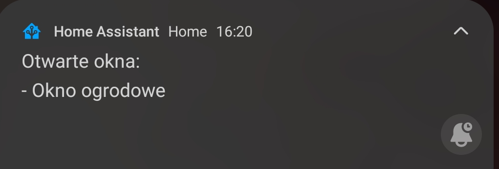

:grinning:Tak na szybko
automatyzacja
alias: test powiadomień
description: ""
trigger:
  - platform: state
    entity_id:
      - binary_sensor.on_off_frontowe_contact
      - binary_sensor.on_off_ogrodowe_contact
      - binary_sensor.on_off_okno_salon_contact
      - binary_sensor.on_off_brama_garazowa_contact
    to: "on"
condition: []
action:
  - service: notify.mobile_app_sm_g975f
    data_template:
      message: >
        Otwarte okna: {% if is_state('binary_sensor.on_off_frontowe_contact',
        'on') %}
          - Okno frontowe
        {% endif %} {% if is_state('binary_sensor.on_off_ogrodowe_contact',
        'on') %}
          - Okno ogrodowe
        {% endif %} {% if is_state('binary_sensor.on_off_okno_salon_contact',
        'on') %}
          - Okno salonu
        {% endif %} {% if
        is_state('binary_sensor.on_off_brama_garazowa_contact', 'on') %}
          - Brama garażowa
        {% endif %}
mode: single
Powiadomienie na telefonie(android)
