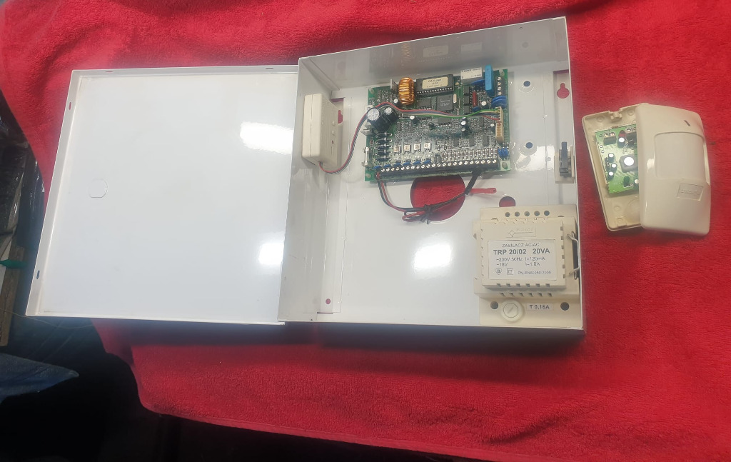

More than a year ago, I had an idea to integrate my old Satel CA-6 to Home Assistant. The sensors were there around the house, but I could not use them, as the CA-6 has no feasible output iption for that, but the keypad. I did not want to rebuild the whole thing with an ESP board, but I wanted to have access to which sensor is triggered with a nice solution, so started to look at how is the keypad working. As it turned out, the keypad does not have any encryption towards the main board of the alarm, it is absolutely non-encrypted communication. So with a logic analyser I jumped on it and figure out the basics for it, and documented in this proof of concept project:

I built my CA-6 integration in a few days time, as a proof of concept, on a “live” system, without a programmer or knowing how exactly the alarm module was programmed. It started as an idea, like what if I can imitate the LEDs on the control panel, and started to look at images on the internet what are the electrical components of the keypad, and figured out that the it is just simple bit-banging without any encryption or anything.

And just a note on installers as my experience. There are many people who just installs them and not interested about them at all. When I went through my alarm system, I had to recognise that the wiring is just a huge mess. Even it is an old alarm system, it support EOL (End Of Line) resistors. Meaning, that with a sensor connected there should be a fixed resistance on the line when it is connected. This way the system know that there is no tampering with the sensor, the cable has not been cut and/or shorted. These resistors should be installed as the name suggest, at the end of the line, so at the sensor, inside the sensor housing. What I have found was that all the resistors are connected to the wires at the alarm module, meaning the whole concept is not working and the sensor can be tampered with. This is a direct result of a lazy and/or uneducated installer. So, you might find somebody, who installs them, but has no clue about what he is actually doing.
