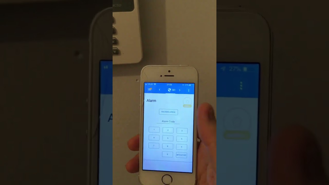

Or you can have a look at this video:
There are links in the description where the author hacked together a system with SMS communication.
