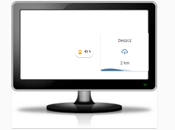

Typy kard można “miksować”
Na przykład karta custom:mushroom-chips-card w picture-elements
type: picture-elements
image: /local/tv.jpg
elements:
  - type: custom:mushroom-chips-card
    chips:
      - type: template
        entity: sensor.sm_g975f_battery_level
        content: '{{ states(entity) }} %'
        icon: |2
                    {% set bl = states('sensor.sm_g975f_battery_level') | int %}
                    {% if bl < 10 %} mdi:battery-outline
                    {% elif bl < 20 %} mdi:battery-10
                    {% elif bl < 30 %} mdi:battery-20
                    {% elif bl < 40 %} mdi:battery-30
                    {% elif bl < 50 %} mdi:battery-40
                    {% elif bl < 60 %} mdi:battery-50
                    {% elif bl < 70 %} mdi:battery-60
                    {% elif bl < 80 %} mdi:battery-70
                    {% elif bl < 90 %} mdi:battery-80
                    {% elif bl < 100 %} mdi:battery-90
                    {% elif bl == 100 %} mdi:battery
                    {% else %} mdi:battery-unknown
                    {% endif %}
        icon_color: |2-
                    {% if bl < 10 %} red
                    {% elif bl < 20 %} red
                    {% elif bl < 30 %} red
                    {% elif bl < 40 %} orange
                    {% elif bl < 50 %} orange
                    {% elif bl < 60 %} green
                    {% elif bl < 70 %} green
                    {% elif bl < 80 %} green
                    {% elif bl < 90 %} green
                    {% elif bl < 100 %} green
                    {% elif bl == 100 %} green
                    {% else %} grey
                    {% endif %}
    style:
      left: 50%
      top: 40%
  - type: custom:fluid-level-background-card
    card:
      type: glance
      entities:
        - entity: sensor.pogoda_nearest_storm_distance
    fill_entity: sensor.pogoda_nearest_storm_distance
    level_color:
      - 68
      - 115
      - 159
    style:
      left: 78%
      top: 40%
      width: 33%
