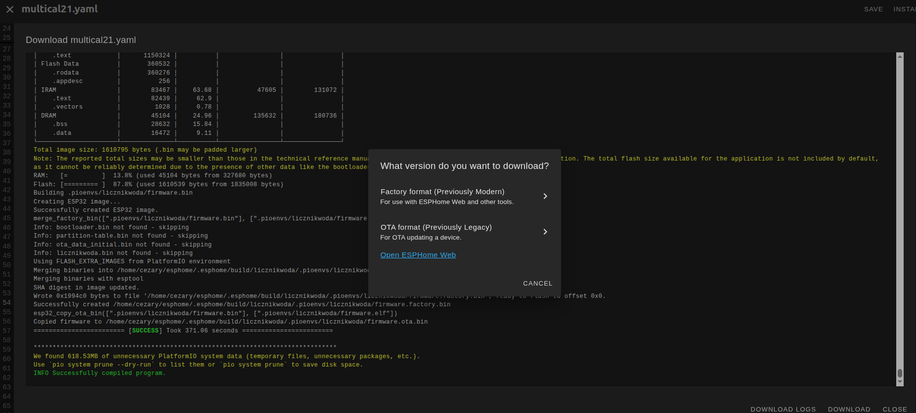

Już prawie widziałem koniec a tu błąd:
Compiling .pioenvs/multical21/src/esphome/components/wmbus/manufacturer_specificities.cpp.o
Compiling .pioenvs/multical21/src/esphome/components/wmbus/mbus.cpp.o
Compiling .pioenvs/multical21/src/esphome/components/wmbus/meters.cpp.o
Compiling .pioenvs/multical21/src/esphome/components/wmbus/rf_cc1101.cpp.o
In file included from src/esphome/components/wmbus/rf_cc1101.h:9,
                 from src/esphome/components/wmbus/rf_cc1101.cpp:1:
src/esphome/components/wmbus/cc1101_rf_settings.h:3:10: fatal error: ELECHOUSE_CC1101_SRC_DRV.h: No such file or directory
* Looking for ELECHOUSE_CC1101_SRC_DRV.h dependency? Check our library registry!
* CLI  > platformio lib search "header:ELECHOUSE_CC1101_SRC_DRV.h"
* Web  > https://registry.platformio.org/search?q=header:%1B%5Bm%1B%5BKELECHOUSE_CC1101_SRC_DRV.h
    3 | #include <ELECHOUSE_CC1101_SRC_DRV.h>
compilation terminated.
*** [.pioenvs/multical21/src/esphome/components/wmbus/rf_cc1101.cpp.o] Error 1
========================= [FAILED] Took 178.90 seconds =========================

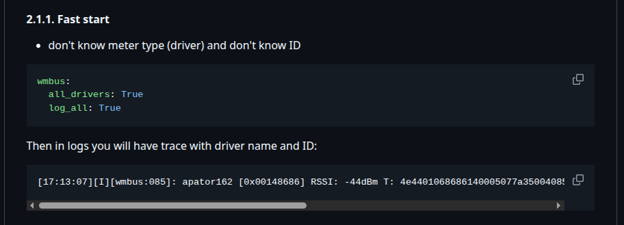

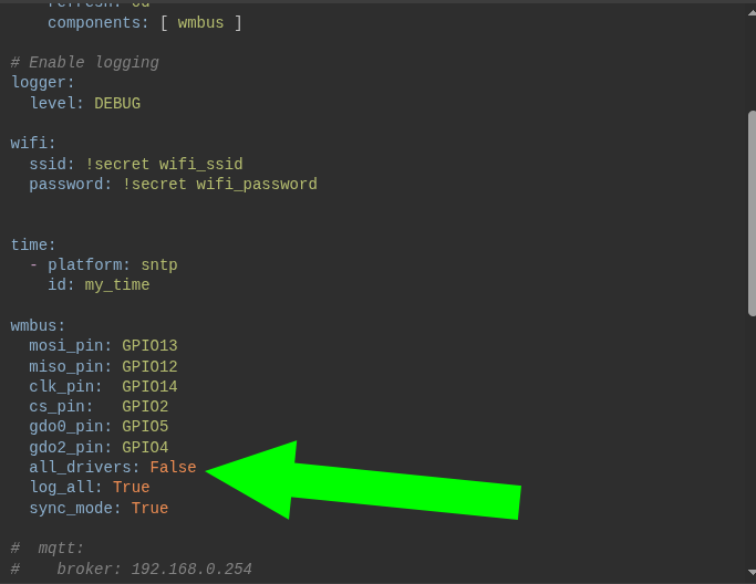

Debug już masz włączony.
  level: DEBUG
Ustawił bym all_drivers na True (tak dla pewności).
Wywalił bym sekcję clients oraz sensor (na czas testów).
Czyli w sumie zrobił tak jak to jest w dokumentacji.
  friendly_name: licznikwoda
  board: esp32dev
    type: arduino
external_components:
    refresh: 0d
    components: [ wmbus ]
# Enable logging
  level: DEBUG
  ssid: !secret wifi_ssid
time:
  - platform: sntp
wmbus:
  mosi_pin: GPIO13
  miso_pin: GPIO12
  clk_pin:  GPIO14
  cs_pin:   GPIO2
  gdo0_pin: GPIO5
  gdo2_pin: GPIO4
  all_drivers: False
  log_all: True
  sync_mode: True
#  mqtt:
#    broker: 192.168.0.254
  clients:
    - name: "wmbusmeters"
      ip_address: "192.168.0.254"
      port: 7227
  - platform: wmbus
    type: multical21
  - platform: wmbus
    meter_id: 57199574
    type: multical21
    key: "9368D8464A53D2FBF953CD9A597F9889"
    sensors:
      - name: "Multical Cold Water Total"
        field: "total"
        unit_of_measurement: "m³"
        device_class: "water"
        icon: "mdi:water"
      - name: "Multical RSSI"
        field: "rssi"
        unit_of_measurement: "dBm"
        state_class: "measurement"
        entity_category: "diagnostic"
      - name: "Multical Cold Water Target"
        field: "target"
        accuracy_decimals: 3
        icon: "mdi:water"
Uprościłem YAML według wskazówek (wszystkie drivery i bez sensorów) i kompiluję.
