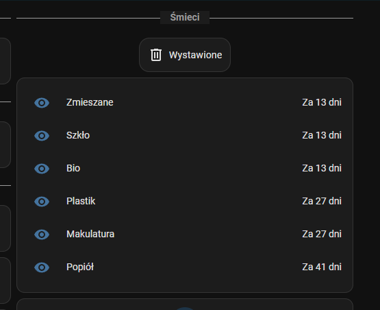

Czy coś takiego masz na myśli:
Treść konfiguracji z coniguration.yaml dla jednej z frakcji:
  - sensor:
      - name: Popiół
        state: >-
          {% set t = now() %}
          {% set midnight = today_at() %}
          {% set event = state_attr('calendar.popiol', 'start_time') | as_datetime | as_local %}
          {% set delta = event - midnight %}
          {% if delta.days == 0 %}
            Dziś
          {% elif delta.days == 1 %}
            Jutro
          {% elif delta.days == 2 %}
            Pojutrz
          {% else %}
            Za {{ delta.days }} dni
          {% endif %}
        attributes:
          days: >-
            {{ ((state_attr('calendar.popiol','start_time') | as_timestamp - today_at('00:00') | as_timestamp) / 86400) | int }}
          data: >-
            {{ state_attr('calendar.popiol','start_time') }}
I jeszcze w dashbordzie:
type: vertical-stack
cards:
  - type: custom:text-divider-row
    text: Śmieci
  - type: vertical-stack
    cards:
      - type: custom:mushroom-chips-card
        chips:
          - type: entity
            entity: input_boolean.smieci
            icon: mdi:trash-can-outline
            content_info: name
            tap_action:
              action: toggle
            icon_color: red
        alignment: center
        card_mod:
          style: |
            :host {
              --mush-chip-spacing: 8px;
              --mush-chip-padding: 0 0.25em;
              --mush-chip-height: 48px;
              --mush-chip-border-radius: 15px;
              --mush-chip-font-size: 0.3em;
              --mush-chip-font-weight:
              --mush-chip-icon-size: 0.5em;
              --mush-chip-avatar-padding: 0.1em;
              --mush-chip-avatar-border-radius: 50%;
              --mush-chip-box-shadow: var(--ha-card-box-shadow);
              --mush-chip-background: var(--ha-card-background);
      - type: custom:auto-entities
        card:
          type: entities
          show_header_toggle: false
        filter:
          include:
            - entity_id: sensor.zmieszan*
            - entity_id: sensor.plasti*
            - entity_id: sensor.szklo*
            - entity_id: sensor.bio*
            - entity_id: sensor.maku*
            - entity_id: sensor.popi*
        unique: entity
        sort:
          method: attribute
          attribute: days
          numeric: true
          reverse: false
          first: 0
          count: 6
