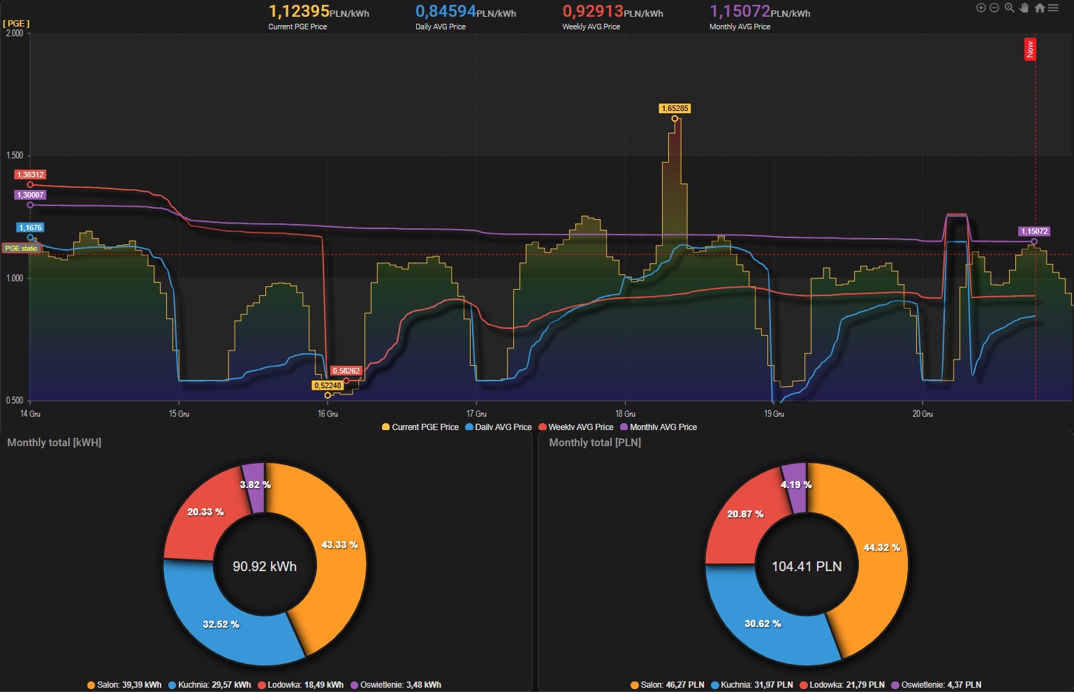

załączam wykresy srednich cen, jestem na minus ale energia na swieta jak widze tanieje, a do upieczenia indyk i pizza :slight_smile: /ostatnie skoki po 20.12 to problemy z HA

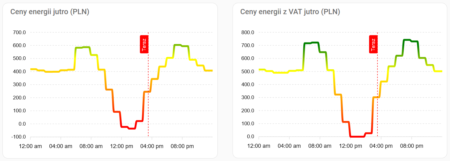

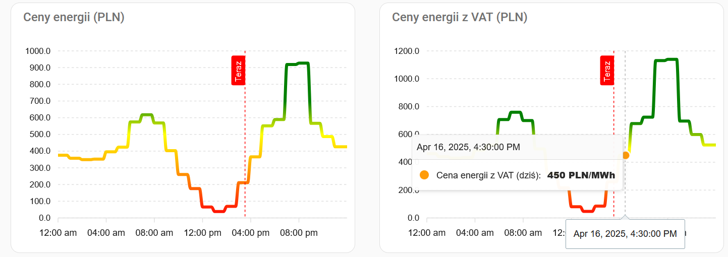

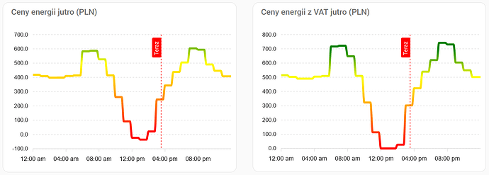

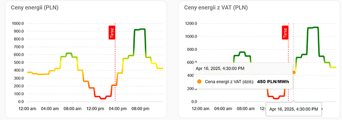

Dodałem sobie pomocnika i wykres RCE, który ogarnia temat realnych wartości dla prosumentów (z VAT i cena minimalna 0).
Korzystam z implementacji z posta 40, z mała poprawką na dzień jutrzejszy.
Poprawka na nowe API
  - platform: rest
    name: RCE Prices Tomorrow
    unique_id: rce_prices_tomorrow_2
    resource_template: "https://v1.api.raporty.pse.pl/api/rce-pln?$select=rce_pln,udtczas_oreb&$filter=doba eq '{{ (now() + timedelta(days=1)).strftime('%Y-%m-%d') }}'"
    method: GET
    headers:
      accept: "application/json"
    value_template: "{{ value_json.value[0]['rce_pln'] }}"
    json_attributes:
      - value
    scan_interval: 3600
      - name: "RCE Prices Today Scaled"
        unique_id: rce_prices_today_scaled
        unit_of_measurement: "PLN/MWh"
        state: >
          {% set raw = state_attr('sensor.rce_prices_today_2', 'value') %}
          {% if raw %}
            {% set cena = raw[0].rce_pln | float %}
            {% set przeliczona = (cena * 1.23) if cena >= 0 else 0 %}
            {{ przeliczona | round(2) }}
          {% else %}
            unknown
          {% endif %}
        attributes:
          value: >
            {% if raw %}
              {% set ns = namespace(result=[]) %}
              {% for item in raw %}
                {% set cena = item.rce_pln | float %}
                {% set entry = {
                  'rce_pln': przeliczona | round(2),
                  'udtczas_oreb': item.udtczas_oreb
                {% set ns.result = ns.result + [entry] %}
              {% endfor %}
              {{ ns.result }}
            {% else %}
            {% endif %}
      - name: "RCE Prices Tomorrow Scaled"
        unique_id: rce_prices_tomorrow_scaled
        state: >
          {% set raw = state_attr('sensor.rce_prices_tomorrow_2', 'value') %}
          {% if raw %}
          {% else %}
            unknown
          {% endif %}
        attributes:
          value: >
            {% if raw %}
                {% set entry = {
              {% endfor %}
              {{ ns.result }}
            {% else %}
            {% endif %}
type: custom:apexcharts-card
graph_span: 24h
span:
  start: day
update_interval: 15min
experimental:
  color_threshold: true
series:
  - entity: sensor.rce_prices_today_scaled
    attribute: value
    data_generator: |
      const startOfDay = new Date();
      startOfDay.setHours(0, 0, 0, 0);
      return entity.attributes.value.map(item => {
        const timeRange = item.udtczas_oreb.split(" - ")[0];
        const [hours, minutes] = timeRange.split(":");
        const timestamp = new Date(startOfDay);
        timestamp.setHours(hours, minutes);
        return [timestamp.getTime(), item.rce_pln];
    type: line
    name: Cena energii z VAT (dziś)
    curve: smooth
    stroke_width: 4
    color_threshold:
      - value: 0
        color: red
      - value: 300
        color: orange
      - value: 500
        color: yellow
      - value: 700
        color: green
header:
  show: true
  title: Ceny energii z VAT (PLN)
  show_states: false
  colorize_states: true
now:
  show: true
  label: Teraz
  color: red

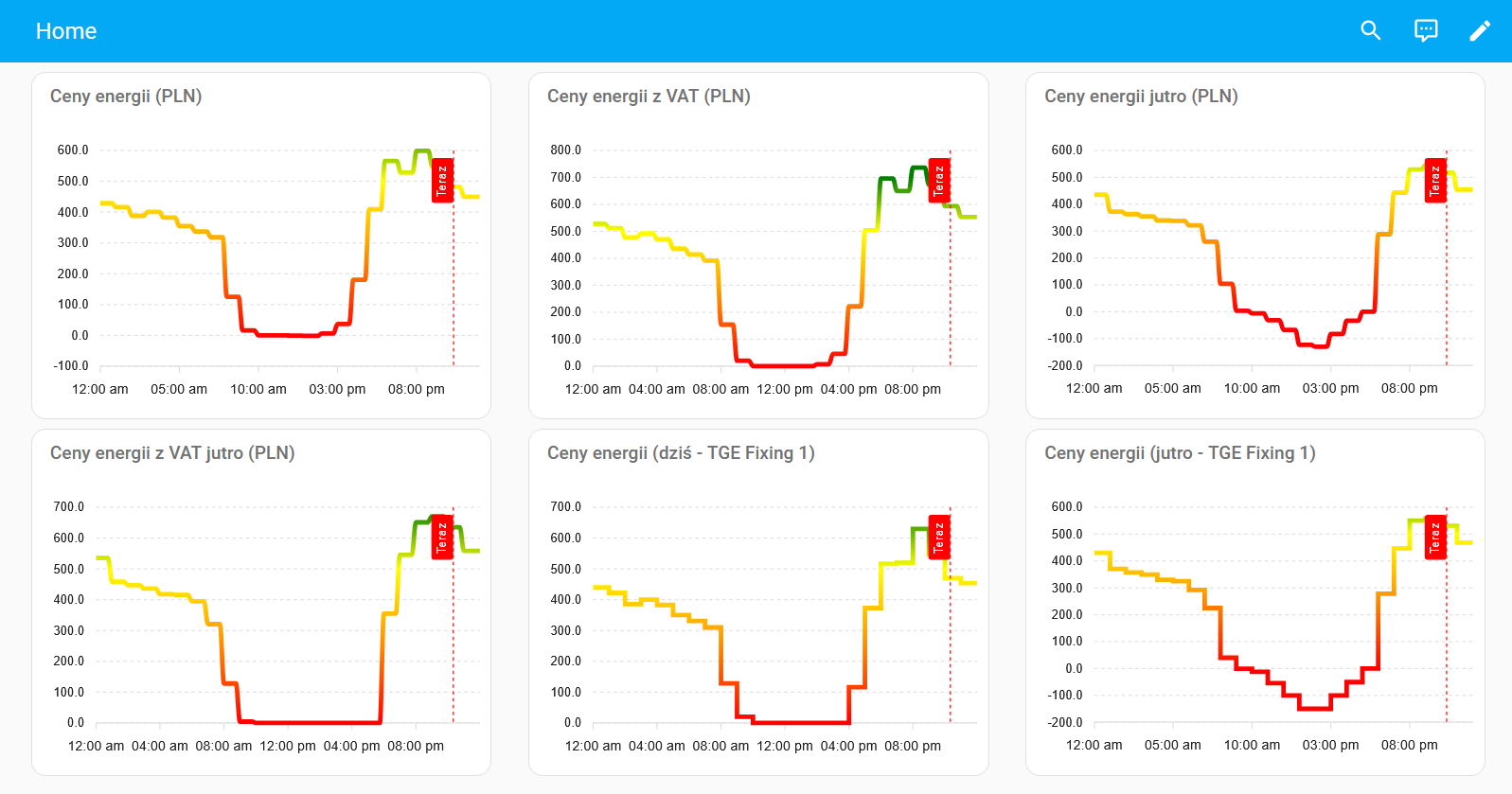

Na koniec na zapas zrobilem sobie wykresy cen RDN z integracji GitHub - PiotrMachowski/Home-Assistant-custom-components-TGE: This custom integration retrieves energy prices from TGE.
graph_span: 24h
span:
  start: day
update_interval: 1h
experimental:
series:
  - entity: sensor.tge_fixing_1_rate
    attribute: prices_today
    data_generator: |
      return entity.attributes.prices_today.map(item => {
        return [new Date(item.time).getTime(), item.price];
    type: line
    name: Cena energii RDN (dziś)
    curve: stepline
    stroke_width: 4
    color_threshold:
      - value: 0
        color: red
      - value: 300
        color: orange
      - value: 500
        color: yellow
      - value: 700
        color: green
header:
  show: true
  title: Ceny energii (dziś - TGE Fixing 1)
  show_states: false
now:
  show: true
  label: Teraz
  color: red
graph_span: 24h
span:
  start: day
experimental:
series:
    attribute: prices_tomorrow
    data_generator: |
      const startOfToday = new Date();
      startOfToday.setHours(0, 0, 0, 0);
      return entity.attributes.prices_tomorrow.map(item => {
        const dateObj = new Date(item.time);
        const hours = dateObj.getHours();
        const minutes = dateObj.getMinutes();
        const timestamp = new Date(startOfToday);
        return [timestamp.getTime(), item.price];
    type: line
    name: Cena energii (jutro)
    curve: stepline
    stroke_width: 4
    color_threshold:
      - value: 0
        color: red
      - value: 300
        color: orange
      - value: 500
        color: yellow
      - value: 700
        color: green
header:
  show: true
  title: Ceny energii (jutro - TGE Fixing 1)
  show_states: false
now:
  show: true
  label: Teraz
  color: red
