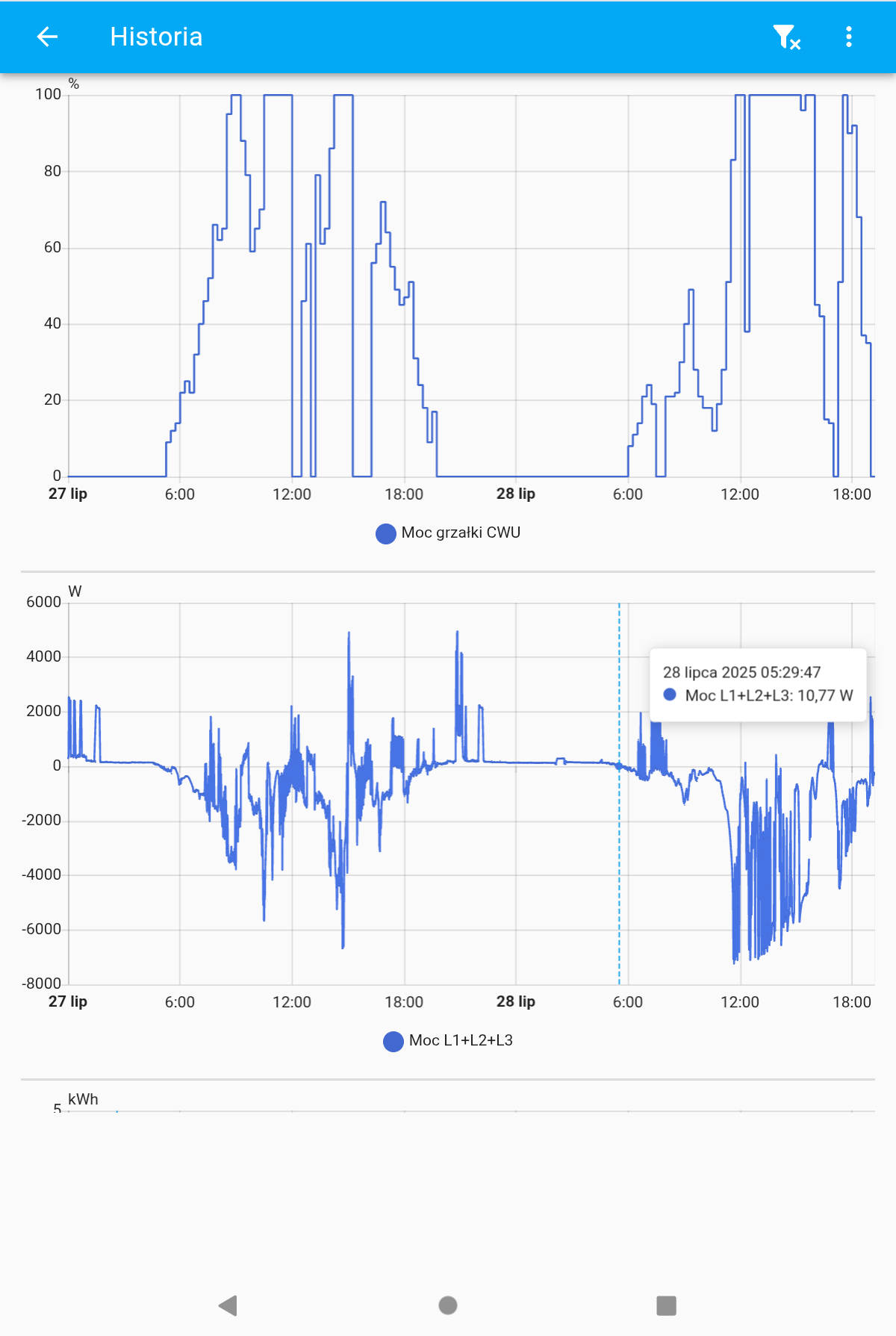

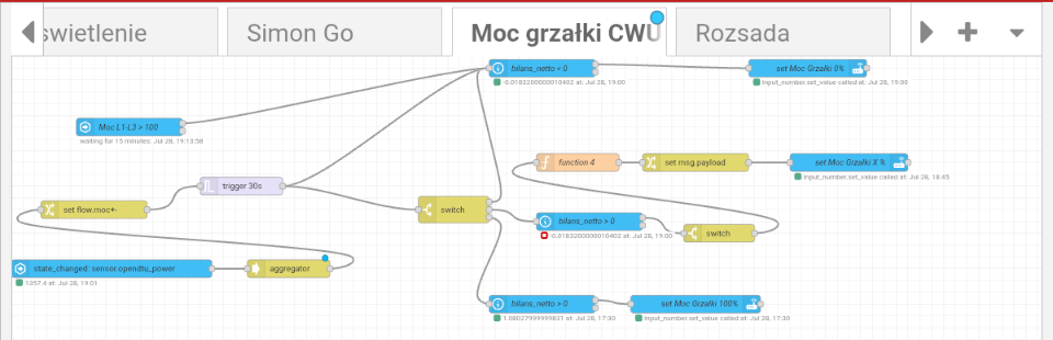

W zasadzie to wyżej wymieniony robi tylko musisz dostosować do swoich potrzeb.
[{"id":"10e9f99f0e869ee8","type":"tab","label":"Moc grzałki CWU","disabled":false,"info":"","env":[]},{"id":"e1b13715c4844995","type":"switch","z":"10e9f99f0e869ee8","name":"","property":"moc+-","propertyType":"flow","rules":[{"t":"lte","v":"139","vt":"num"},{"t":"gte","v":"200","vt":"num"},{"t":"gte","v":"2700","vt":"num"}],"checkall":"true","repair":false,"outputs":3,"x":750,"y":260,"wires":[["65790f5c70e7e714"],["d07f5ca2727db04e"],["164694fc0fad2ea8"]]},{"id":"d9908881644c301c","type":"api-call-service","z":"10e9f99f0e869ee8","name":"set Moc Grzałki 0% ","server":"50bc555c.bd793c","version":7,"debugenabled":false,"action":"input_number.set_value","floorId":[],"areaId":[],"deviceId":[],"entityId":["input_number.moc_grzalki_cwu"],"labelId":[],"data":"{\"value\":0}","dataType":"jsonata","mergeContext":"","mustacheAltTags":false,"outputProperties":[],"queue":"none","blockInputOverrides":true,"domain":"input_number","service":"set_value","x":1350,"y":20,"wires":[[]]},{"id":"8329a268c308d696","type":"api-call-service","z":"10e9f99f0e869ee8","name":"set Moc Grzałki 100% ","server":"50bc555c.bd793c","version":7,"debugenabled":false,"action":"input_number.set_value","floorId":[],"areaId":[],"deviceId":[],"entityId":["input_number.moc_grzalki_cwu"],"labelId":[],"data":"{\"value\":100}","dataType":"jsonata","mergeContext":"","mustacheAltTags":false,"outputProperties":[],"queue":"none","blockInputOverrides":true,"domain":"input_number","service":"set_value","x":1160,"y":420,"wires":[[]]},{"id":"11969fdbeea4129e","type":"function","z":"10e9f99f0e869ee8","name":"function 4","func":"msg.payload = ( flow.get(\"moc+-\") / 2700 * 100 )\nreturn msg;","outputs":1,"timeout":0,"noerr":0,"initialize":"","finalize":"","libs":[],"x":960,"y":180,"wires":[["d43a67ba9607cbb0"]]},{"id":"b35e694791a9524f","type":"api-call-service","z":"10e9f99f0e869ee8","name":"set Moc Grzałki X % ","server":"50bc555c.bd793c","version":7,"debugenabled":false,"action":"input_number.set_value","floorId":[],"areaId":[],"deviceId":[],"entityId":["input_number.moc_grzalki_cwu"],"labelId":[],"data":"{\"value\":msg.payload}","dataType":"jsonata","mergeContext":"","mustacheAltTags":false,"outputProperties":[],"queue":"none","blockInputOverrides":true,"domain":"input_number","service":"set_value","x":1420,"y":180,"wires":[[]]},{"id":"d43a67ba9607cbb0","type":"change","z":"10e9f99f0e869ee8","name":"","rules":[{"t":"set","p":"payload","pt":"msg","to":"$round(payload, 0)","tot":"jsonata"}],"action":"","property":"","from":"","to":"","reg":false,"x":1160,"y":180,"wires":[["b35e694791a9524f"]]},{"id":"a90ab3be81a65956","type":"switch","z":"10e9f99f0e869ee8","name":"","property":"moc+-","propertyType":"flow","rules":[{"t":"lte","v":"2700","vt":"num"}],"checkall":"true","repair":false,"outputs":1,"x":1200,"y":300,"wires":[["11969fdbeea4129e"]]},{"id":"9271f74d2a57f275","type":"trigger","z":"10e9f99f0e869ee8","name":"","op1":"","op2":"moc+-","op1type":"nul","op2type":"flow","duration":"30","extend":false,"overrideDelay":false,"units":"s","reset":"","bytopic":"all","topic":"topic","outputs":1,"x":390,"y":220,"wires":[["65790f5c70e7e714","e1b13715c4844995"]]},{"id":"65790f5c70e7e714","type":"api-current-state","z":"10e9f99f0e869ee8","name":"bilans_netto < 0","server":"50bc555c.bd793c","version":3,"outputs":2,"halt_if":"0","halt_if_type":"num","halt_if_compare":"lte","entity_id":"sensor.energia_bilans_netto","state_type":"str","blockInputOverrides":true,"outputProperties":[{"property":"payload","propertyType":"msg","value":"","valueType":"entityState"},{"property":"data","propertyType":"msg","value":"","valueType":"entity"}],"for":"0","forType":"num","forUnits":"minutes","override_topic":false,"state_location":"payload","override_payload":"msg","entity_location":"data","override_data":"msg","x":900,"y":20,"wires":[["d9908881644c301c"],[]]},{"id":"164694fc0fad2ea8","type":"api-current-state","z":"10e9f99f0e869ee8","name":"bilans_netto > 0","server":"50bc555c.bd793c","version":3,"outputs":2,"halt_if":"0","halt_if_type":"num","halt_if_compare":"gte","entity_id":"sensor.energia_bilans_netto","state_type":"str","blockInputOverrides":true,"outputProperties":[{"property":"moc+-","propertyType":"flow","value":"moc+-","valueType":"flow"},{"property":"data","propertyType":"msg","value":"","valueType":"entity"}],"for":"0","forType":"num","forUnits":"minutes","override_topic":false,"state_location":"payload","override_payload":"msg","entity_location":"data","override_data":"msg","x":900,"y":420,"wires":[["8329a268c308d696"],[]]},{"id":"d07f5ca2727db04e","type":"api-current-state","z":"10e9f99f0e869ee8","name":"bilans_netto > 0","server":"50bc555c.bd793c","version":3,"outputs":2,"halt_if":"0","halt_if_type":"num","halt_if_compare":"gte","entity_id":"sensor.energia_bilans_netto","state_type":"str","blockInputOverrides":true,"outputProperties":[{"property":"moc+-","propertyType":"flow","value":"moc+-","valueType":"flow"},{"property":"data","propertyType":"msg","value":"","valueType":"entity"}],"for":"0","forType":"num","forUnits":"minutes","override_topic":false,"state_location":"payload","override_payload":"msg","entity_location":"data","override_data":"msg","x":980,"y":280,"wires":[["a90ab3be81a65956"],[]]},{"id":"946c090f888754ca","type":"server-state-changed","z":"10e9f99f0e869ee8","name":"Moc L1-L3 > 100","server":"50bc555c.bd793c","version":6,"outputs":2,"exposeAsEntityConfig":"","entities":{"entity":["sensor.moc_l1_l2_l3"],"substring":[],"regex":[]},"outputInitially":false,"stateType":"str","ifState":"100","ifStateType":"num","ifStateOperator":"gte","outputOnlyOnStateChange":true,"for":"15","forType":"num","forUnits":"minutes","ignorePrevStateNull":false,"ignorePrevStateUnknown":false,"ignorePrevStateUnavailable":false,"ignoreCurrentStateUnknown":false,"ignoreCurrentStateUnavailable":false,"outputProperties":[{"property":"payload","propertyType":"msg","value":"","valueType":"entityState"},{"property":"data","propertyType":"msg","value":"","valueType":"eventData"},{"property":"topic","propertyType":"msg","value":"","valueType":"triggerId"}],"x":240,"y":40,"wires":[["65790f5c70e7e714"],[]]},{"id":"fc28148650356228","type":"aggregator","z":"10e9f99f0e869ee8","name":"","topic":"","intervalCount":"15","intervalUnits":"m","submitIncompleteInterval":true,"submitPerTopic":false,"aggregationType":"mean","x":450,"y":360,"wires":[["cf0fa9e17adef67d"]]},{"id":"bce5b98779b00580","type":"server-state-changed","z":"10e9f99f0e869ee8","name":"","server":"50bc555c.bd793c","version":6,"outputs":1,"exposeAsEntityConfig":"","entities":{"entity":["sensor.opendtu_power"],"substring":[],"regex":[]},"outputInitially":false,"stateType":"num","ifState":"","ifStateType":"num","ifStateOperator":"is","outputOnlyOnStateChange":true,"for":"0","forType":"num","forUnits":"minutes","ignorePrevStateNull":false,"ignorePrevStateUnknown":false,"ignorePrevStateUnavailable":false,"ignoreCurrentStateUnknown":false,"ignoreCurrentStateUnavailable":false,"outputProperties":[{"property":"payload","propertyType":"msg","value":"","valueType":"entityState"},{"property":"data","propertyType":"msg","value":"","valueType":"eventData"},{"property":"topic","propertyType":"msg","value":"","valueType":"triggerId"}],"x":170,"y":360,"wires":[["fc28148650356228"]]},{"id":"cf0fa9e17adef67d","type":"change","z":"10e9f99f0e869ee8","name":"","rules":[{"t":"set","p":"moc+-","pt":"flow","to":"payload","tot":"msg"}],"action":"","property":"","from":"","to":"","reg":false,"x":140,"y":260,"wires":[["9271f74d2a57f275"]]},{"id":"50bc555c.bd793c","type":"server","name":"Home Assistant","addon":true}]
Tylko zamiast mocy grzałki przeliczyć na prąd ładowania samochodu.

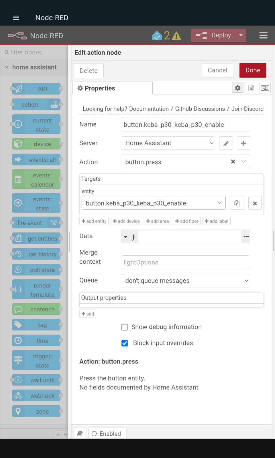

Jeżeli masz wollboxa który zintegrowany jest z Home Assistant
Wejdź w narzędzia deweloperskie wyszukaj wollboxa ustawienia prądu ładowania on/off i zamieść na forum Atrybuty stanu (YAML, opcjonalnie)
Jesli dobrze Cie zrozumiealem - to pytasz o encję, która załącza/wyłącza ładowanie.
W moim przypadku jest to:
“button.keba_p30_keba_p30_enable” oraz “button.keba_p30_keba_p30_disable”.
Atrybutów to zbyt wiele nie ma.
Są to odpowiednio:
icon: mdi:play
friendly_name: KEBA P30 KEBA P30 Enable
oraz
icon: mdi:stop
friendly_name: KEBA P30 KEBA P30 Disable
Na karcie są widoczne jako przyciski do wciśnięcia, by aktywować/dezaktywować ładowanie.

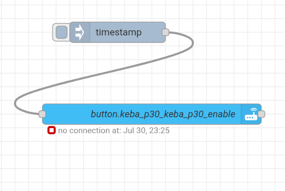

Dodaj noda aciton
Skonfigurować
Nie zmieniaj nazwy serwera.
Dodać noda Inject
Połączyć je ze sobą
Naciśnij Deploy
Po naciśnięciu małego kwadracika w node inject powinno uruchomić ładowanie .

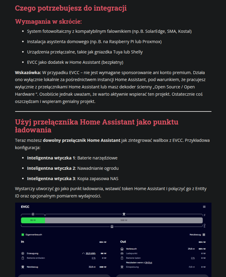

To bardzo ciekawe rozwiązanie open source i darmowe:
Trafiłem na ciekawy przewodnik, nie potrzebny jest NR, ba nie trzeba nic klepać w YAML:
