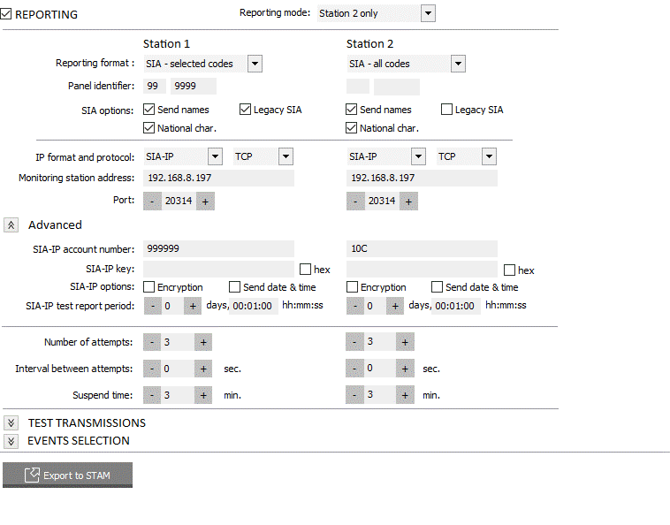

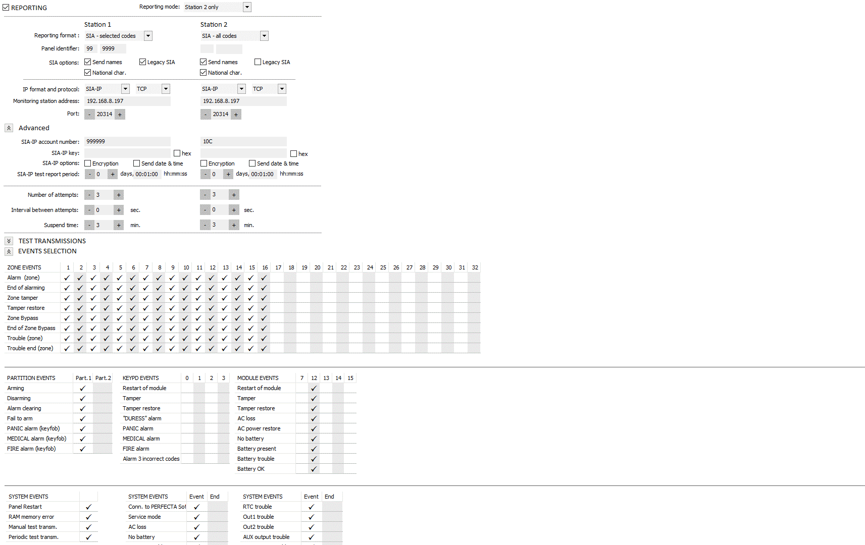

I am attaching a screenshot of relevant section from Perfecta Soft to show how it looks. Station 1 and Station 2 are configured differently because I was switching between the two trying various settings.

Can you try to change 2-3 settings?
On the top, the reporting mode has an option, that it switches between the two if it cannot connect to the SIA station. I think I have seen it in a manual, but I might have mixed it up. Leave the account number different, just to be able to see if it switches between the two.
Enable the send date & time for both, just to see how it works.
Change the interval between attempts for Station 1 to 7 seconds, and for Station 2 for 13 seconds.
This way, you will see in the log, if the it accepts the message and the SIA server replies correctly to Satel.
And turn off for both the National char. option. Looking at the code, it expects only ASCII.
You can try to change the reporting format to Contact ID (CID), the integration supports ADM-CID, or you can try to change the protocol to UDP, but I really don’t think that is the issue.
I assume the SIA server does not reply correctly.

I assume this is how you wanted it to be configured:
It does switch between the two stations in this setup based on the logs:

Try to set the SIA-IP test report period to 0, so it will not send it, and enable it in the Test Transmissions section. I honestly think, that the alarm is not sending the messages, because it thinks that the SIA server is not receiving it.
The alarm supports SIA DC-09 standard according the manual, I guess the Legacy SIA is either SIA DC-05 or 04 or earlier maybe SIA DC-01.

I’ve spent more time looking at this and I think I got to the end of my SIA integration journey, unfortunately it’s not a happy ending.
Here is a summary of what I found:
  1. SIA Integration through Node-RED works much better than official SIA Alarm Systems integration in Home Assistant. It was much easier to debug what was happening after switching to Node-RED.
  2. During my testing I discovered that Satel Perfecta does not transmit sensor violations either via SIA or CID when the system is not armed.
    I opened a ticket with Satel and they confirmed this behavior and they don’t consider this a bug.
  3. I experimented a little bit with various Satel Perfecta settings, to see if I could find a workaround and if I set Zone Type to “Trouble” (“AWARIA” in polish) it sends a SIA message when the violation occurs and another
    SIA message when the violation ends, which is exactly what I would want for home automation. But if zone/sensor is set up like this it will not trigger an alarm if violation occurs when the system is armed.
    I found no zone/sensor setting that would preserve alarm functionality when armed and also allow me to obtain motion and door/window sensor state for home automation.
Yes. I’ve seen this issue in my testing but I found a solution.It occurs with both HA SIA and Node-RED integration but only if “Legacy SIA” checkbox is not checked. If “Legacy SIA” box is checked there are no format issues with SIA messages from Perfecta.
So in summary, it seems that SIA is probably not appropriate for integrating Satel Perfecta alarms with home automation systems if regular alarm functionality is to be preserved but once again, thanks for your help. I certainly learned a lot.

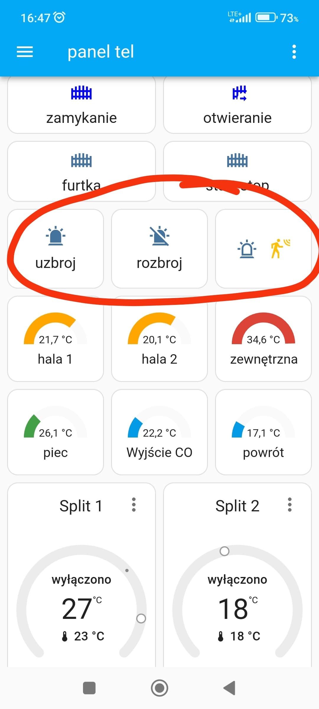

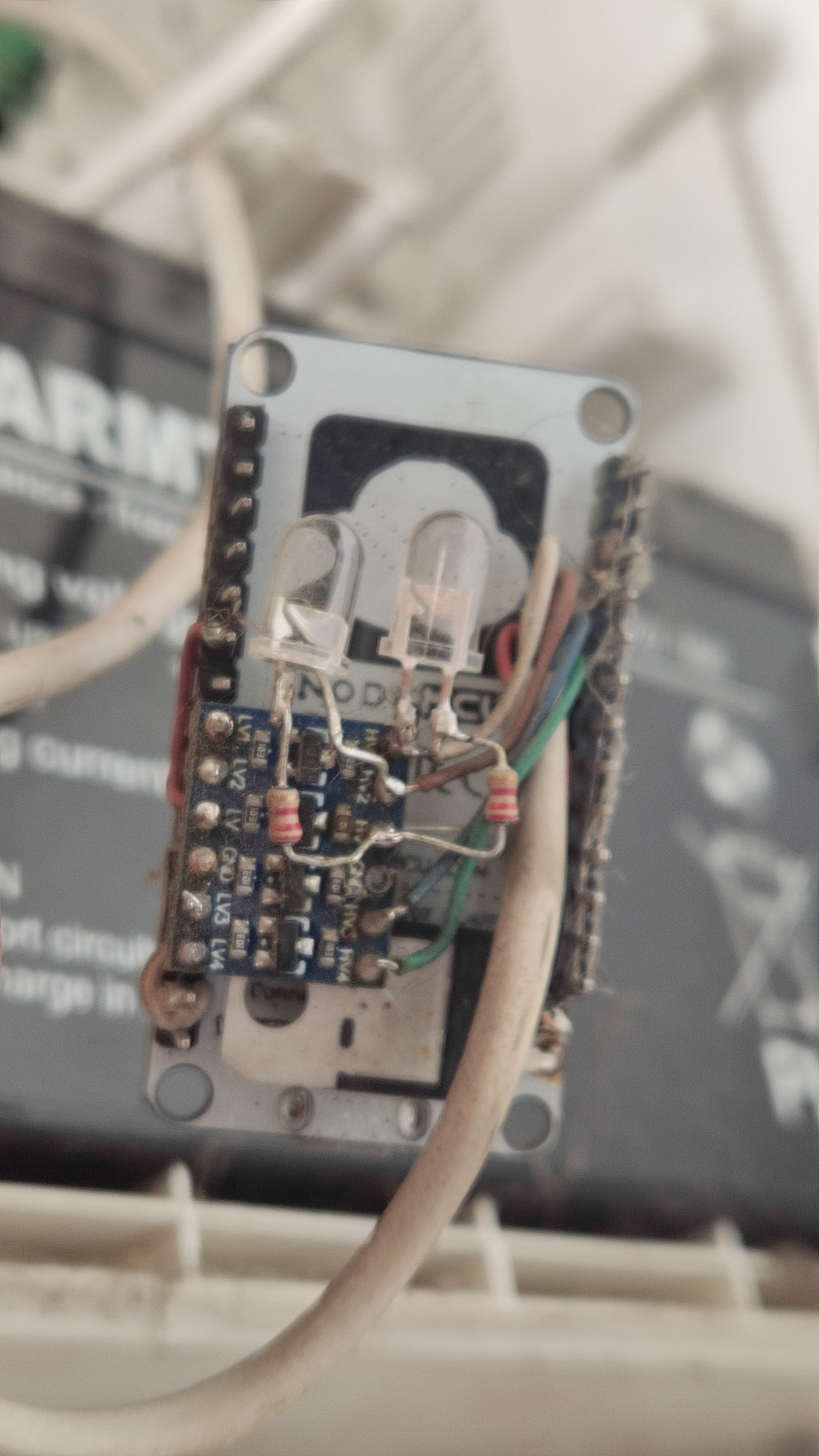

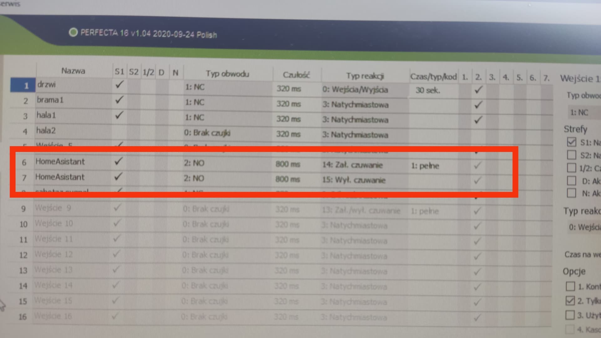

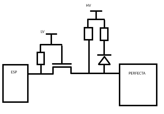

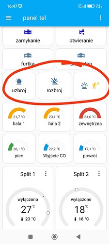

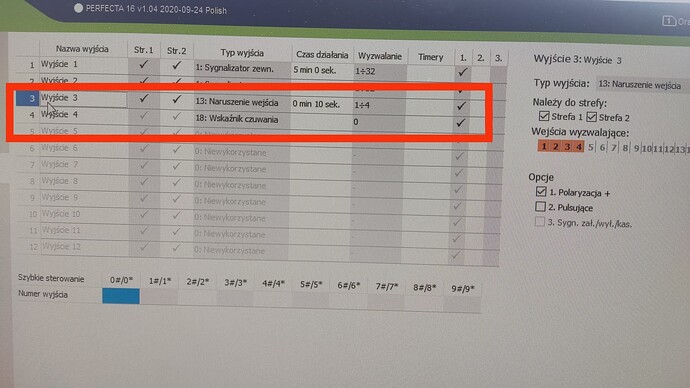

nie wiem czy ogarnąłeś temat ale ja mam zrobione to co potrzebujesz i dodatkowo uzbrajanie i rozbrajanie alarmu z HA. Jeśli starczą ci dwa obwody wyłaczające klime to konfigurujesz w alarmie wyjścia niskoprądowe określając je jako “naruszenie wejścia” i ptaszkami podpinasz do nich czujki z których ma brać sygnał . ESP odseparowujesz konwenterem poziomów logicznych ten na mosfetach nie na układzie scalonym (na allegro 8 zł) i mimo że pisze że są one 3-5V to działają bez problemu na 12V po stronie high V . W ESP robisz 2 wejścia i 2 wyjścia . Potem z tymi encjami robisz na co masz ochotę . Jak masz jeszcze jakieś pytania to pisz
switch:
  - platform: gpio
    pin: 1
    inverted: true
  - platform: gpio
    pin: 3
    inverted: true
  - platform: template
    icon: "mdi:gate"
    turn_on_action:
    - switch.turn_on: AlarmZ
    - delay: 1s
    - switch.turn_off: AlarmZ
    icon: "mdi:gate"
    turn_on_action:
    - switch.turn_on: AlarmW
    - delay: 1s
    - switch.turn_off: AlarmW
binary_sensor:
  - platform: gpio
    pin:
      number: D5
      mode:
        input: true
        pullup: true
      inverted: true
  - platform: gpio
    pin:
      number: D6
      mode:
        input: true
        pullup: true
      inverted: true
Wyłaczenie i załaczenie klimy robisz w automatyzacjach tylko trzeba użyć zmiennej do przechowywania stanu czy przed otwarciem okna była załaczona
Cześć, też właśnie chcę podłączyć HA do perfecty. @Trojan możesz powiedzieć po co dodatkowo diody skoro masz już konwerter na tranzystorach ? Jak to jest spięte bo nie mogę dokładnie wywnioskować ze zdjęcia ? edit: tak wygląda podłączenie ? :
