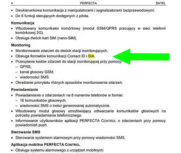

First of all, I have not tried SIA with Perfecta, I don’t have Perfecta. But the Perfecta supports it and HA has SIA integration to integrate alarm systems. The pieces are there from the puzzle, just need to put them together.
The Perfecta line has 11 different versions. Yes, the Perfecta 16 has cellular 2G only, but it supports the mobile app and does communicate TCP/IP or UDP. It has SATEL protocol for remote stations and SIA-IP protocol as well.
https://www.satel.pl/en/product-category/intruder-alarms/perfecta/
For SIA with the GSM versions of the Perfecta you need to call your SIA server (HA integration) from the Internet, it is not local, obviously, because the alarm system is not connected locally to the same network, but only to the internet.

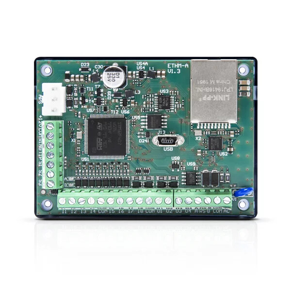

Satel ma też w ofercie moduł komunikacji ETHM-A
https://www.satel.pl/produkty/komunikacja-i-powiadamianie/komunikacja-tcp-ip/ethm-a/

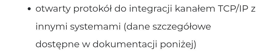

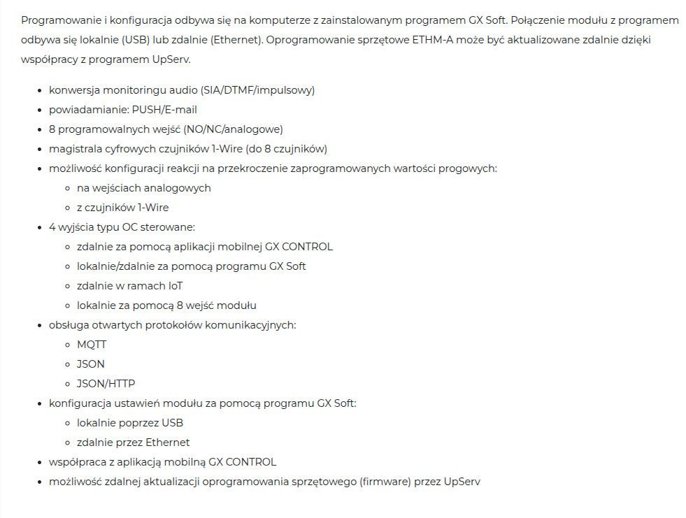

Co ciekawe, podobno współpracuje z dowolną centralą, obsługuje SIA oraz MQTT.
I tried to look at that, but I have not digged too much into the Perfecta ecosystem. If it really works with Perfecta, then there is a solution for everything locally. (Especially with MQTT!)
Edit: I have looked at the page that you linked. It is like a Konnected.io device. Or an ESP connected to the outputs of an existing alarm system. Obviously it is less DIY. But it is not like an expansion module, where the alarm system communicates with it only on just 2 wires and shares all information like it does with a keypad.

Meanwhile the ETHM-A uses the same setup like your ESP question, so the alarm control panel has to be configured to mirror the input to outputs and those outputs are connected to the ETHM-A’s inputs which then can be transmitted to MQTT or SIA or whatever other protocol it supports.

I understand now that ETHM-A is just a universal pre-packaged solution (like Konnected.io) that just happens to be made by Satel and in effect would be the same as ESP. ETHM-1 Plus, which is a proprietary expansion module for some Satel systems is apparently not compatible with Perfecta 16 so is not an option for me.
