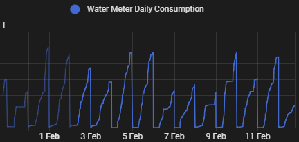

I recently went with the ai-on-the-edge project. I have suitable space for it, power close by, and 3D printed the some components to fit the camera. The results are quite good. Sometimes a bit of miss, but good enough to track consumption on a daily/hourly basis. And better than reading the Anyquest Cyble, which does not send any data during the weekends.
