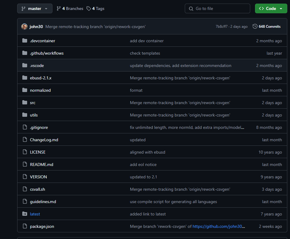

tu masz paczke do wgrania do HA GitHub - john30/ebusd-configuration: ebusd configuration files

Custom CSV or MQTT cfg files:
To use custom config files you can use the configpath option. You can create a local copy of GitHub - john30/ebusd-configuration: ebusd configuration files in your “/config” folder and change configpath to e.g. “/config/ebusd-configuration/latest/en”. Custom CSV files must be in the /config folder.
Similarly for MQTT create config file in “/config” folder and link it using the --mqttint=/config/YOUR_FILE_PATH option
