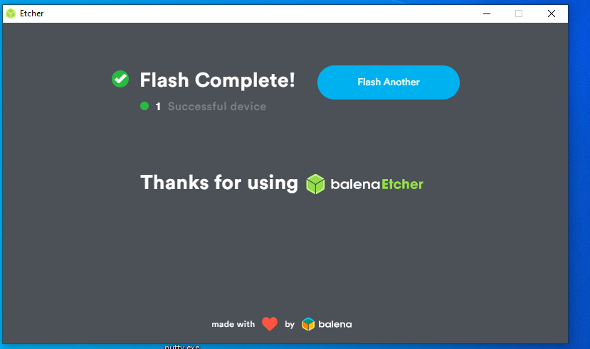

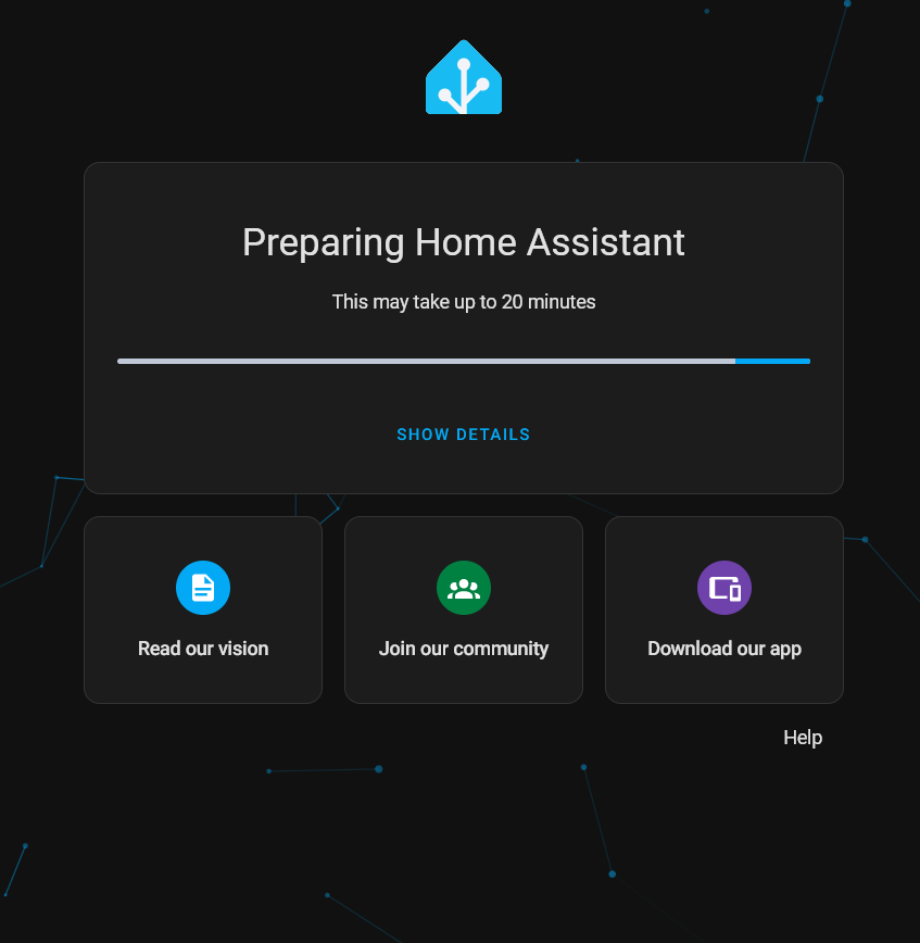

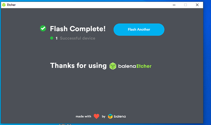

fleszowanie poszło
leci instalacja

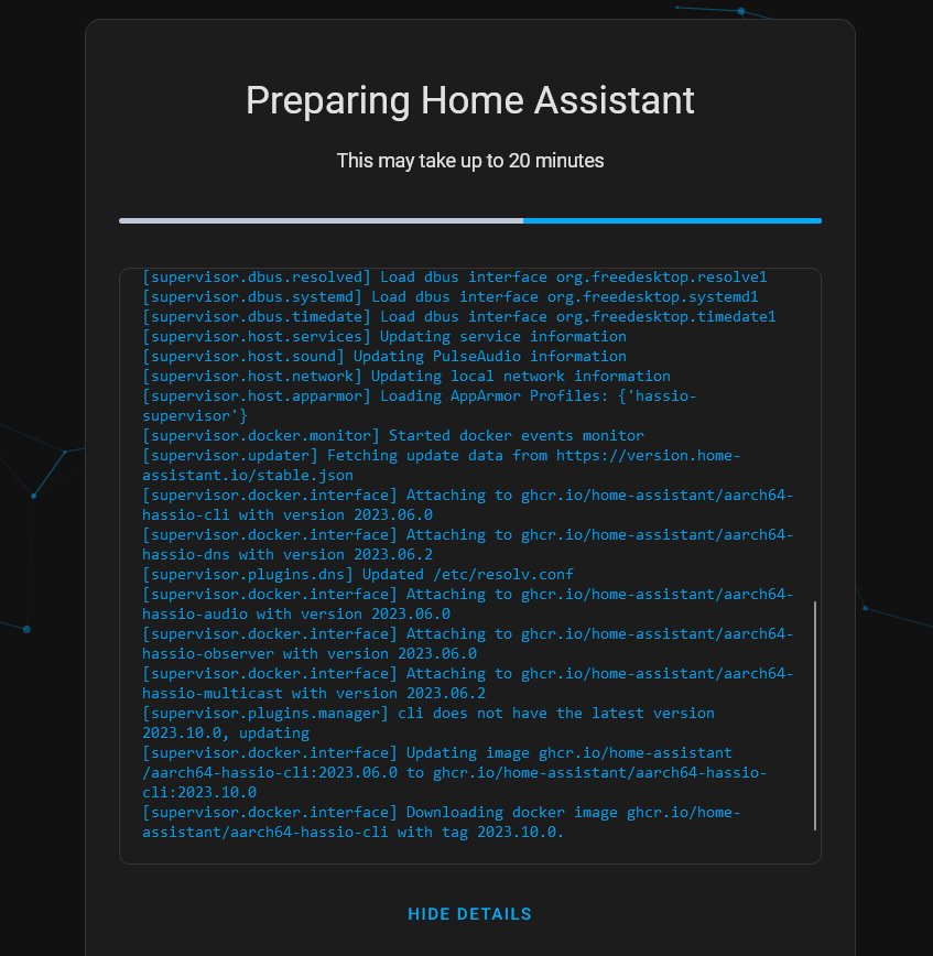

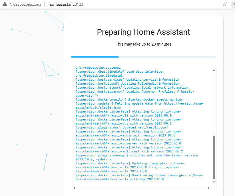

na razie dalej leci, trochę sie inaczej zachowuje, teraz to w tym logu widać jak się cały czas coś zmienia
instalacja nadal leci i w logu widać jak naprawia błędy

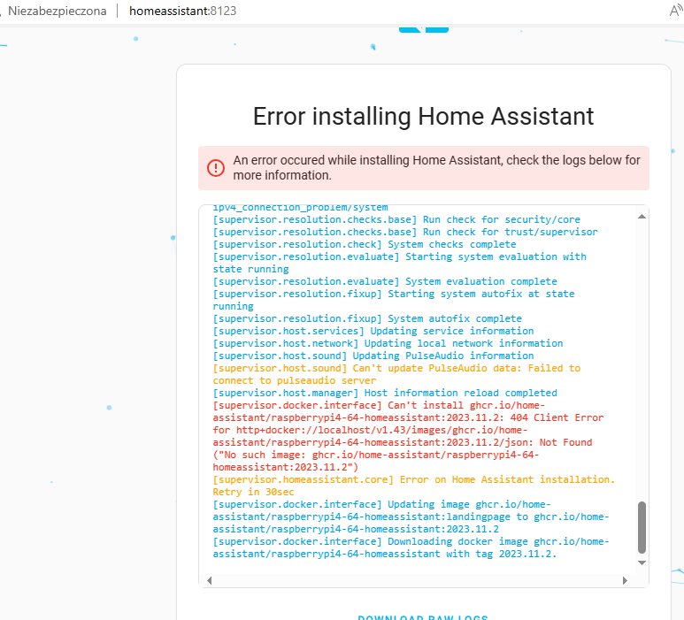

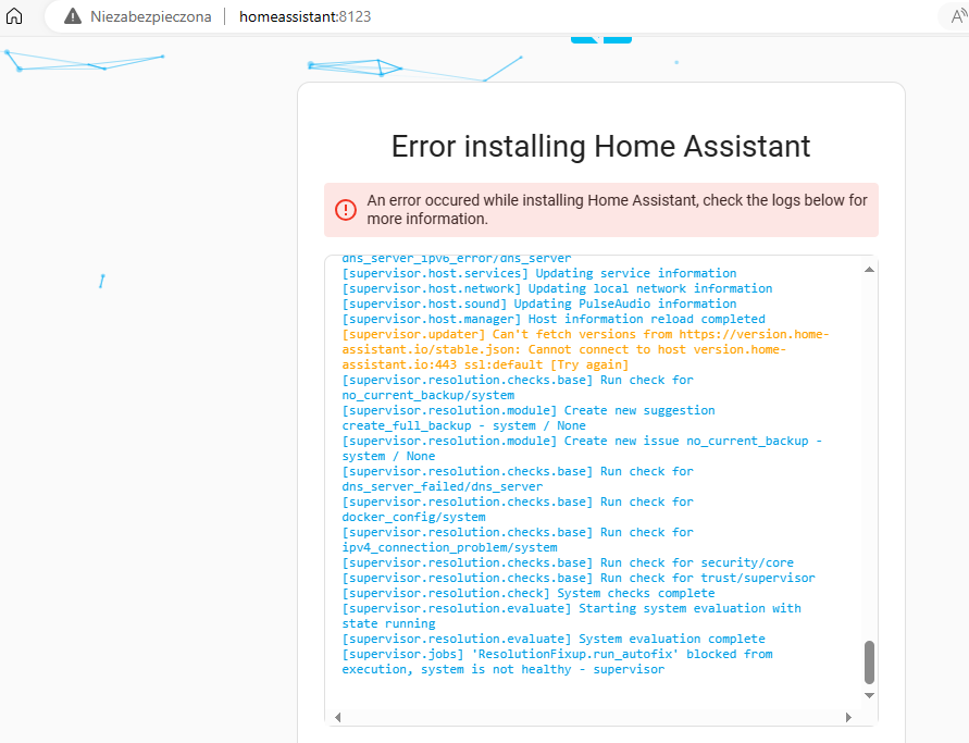

no i niestety długo szło ale nie doszło, znowu wywaliło błędami ale w innym miejscu:
cont-init: info: running /etc/cont-init.d/udev.sh
[22:25:35] INFO: Using udev information from host
cont-init: info: /etc/cont-init.d/udev.sh exited 0
services-up: info: copying legacy longrun supervisor (no readiness notification)
services-up: info: copying legacy longrun watchdog (no readiness notification)
[22:25:35] INFO: Starting local supervisor watchdog…
23-11-15 22:25:37 INFO (MainThread) [main] Initializing Supervisor setup
23-11-15 23:25:38 INFO (MainThread) [supervisor.bootstrap] Seting up coresys for machine: raspberrypi4-64
23-11-15 23:25:38 INFO (MainThread) [supervisor.docker.supervisor] Attaching to Supervisor Package aarch64-hassio-supervisor · GitHub with version 2023.11.3
23-11-15 23:25:38 INFO (MainThread) [supervisor.docker.supervisor] Connecting Supervisor to hassio-network
23-11-15 23:25:44 INFO (SyncWorker_0) [supervisor.docker.manager] Cleanup images: [‘Package aarch64-hassio-supervisor · GitHub’]
23-11-15 23:25:45 INFO (MainThread) [supervisor.resolution.evaluate] Starting system evaluation with state initialize
23-11-15 23:25:45 INFO (MainThread) [supervisor.resolution.evaluate] System evaluation complete
23-11-15 23:25:45 INFO (MainThread) [main] Setting up Supervisor
23-11-15 23:25:46 INFO (MainThread) [supervisor.api] Starting API on 172.30.32.2
23-11-15 23:25:46 INFO (MainThread) [supervisor.hardware.monitor] Started Supervisor hardware monitor
23-11-15 23:25:46 INFO (MainThread) [supervisor.dbus.manager] Connected to system D-Bus.
23-11-15 23:25:46 INFO (MainThread) [supervisor.dbus.agent] Load dbus interface io.hass.os
23-11-15 23:25:46 INFO (MainThread) [supervisor.dbus.hostname] Load dbus interface org.freedesktop.hostname1
23-11-15 23:25:46 INFO (MainThread) [supervisor.dbus.logind] Load dbus interface org.freedesktop.login1
23-11-15 23:25:46 INFO (MainThread) [supervisor.dbus.network] Load dbus interface org.freedesktop.NetworkManager
23-11-15 23:25:46 INFO (MainThread) [supervisor.dbus.rauc] Load dbus interface de.pengutronix.rauc
23-11-15 23:25:46 INFO (MainThread) [supervisor.dbus.resolved] Load dbus interface org.freedesktop.resolve1
23-11-15 23:25:46 INFO (MainThread) [supervisor.dbus.systemd] Load dbus interface org.freedesktop.systemd1
23-11-15 23:25:46 INFO (MainThread) [supervisor.dbus.timedate] Load dbus interface org.freedesktop.timedate1
23-11-15 23:25:47 INFO (MainThread) [supervisor.host.services] Updating service information
23-11-15 23:25:47 INFO (MainThread) [supervisor.host.sound] Updating PulseAudio information
23-11-15 23:25:49 INFO (MainThread) [supervisor.host.network] Updating local network information
23-11-15 23:25:49 INFO (MainThread) [supervisor.host.apparmor] Loading AppArmor Profiles: {‘hassio-supervisor’}
23-11-15 23:25:49 INFO (MainThread) [supervisor.docker.monitor] Started docker events monitor
23-11-15 23:25:49 INFO (MainThread) [supervisor.updater] Fetching update data from https://version.home-assistant.io/stable.json
23-11-15 23:25:52 INFO (MainThread) [supervisor.docker.interface] Attaching to Package aarch64-hassio-cli · GitHub with version 2023.06.0
23-11-15 23:25:52 INFO (MainThread) [supervisor.docker.interface] Attaching to Package aarch64-hassio-dns · GitHub with version 2023.06.2
23-11-15 23:25:52 INFO (MainThread) [supervisor.plugins.dns] Updated /etc/resolv.conf
23-11-15 23:25:52 INFO (MainThread) [supervisor.docker.interface] Attaching to Package aarch64-hassio-audio · GitHub with version 2023.06.0
23-11-15 23:25:53 INFO (MainThread) [supervisor.docker.interface] Attaching to Package aarch64-hassio-observer · GitHub with version 2023.06.0
23-11-15 23:25:53 INFO (MainThread) [supervisor.docker.interface] Attaching to Package aarch64-hassio-multicast · GitHub with version 2023.06.2
23-11-15 23:25:53 INFO (MainThread) [supervisor.plugins.manager] cli does not have the latest version 2023.10.0, updating
23-11-15 23:25:53 INFO (MainThread) [supervisor.docker.interface] Updating image Package aarch64-hassio-cli · GitHub to Package aarch64-hassio-cli · GitHub
23-11-15 23:25:53 INFO (MainThread) [supervisor.docker.interface] Downloading docker image Package aarch64-hassio-cli · GitHub with tag 2023.10.0.
23-11-15 23:29:13 INFO (SyncWorker_1) [supervisor.docker.manager] Stopping hassio_cli application
23-11-15 23:29:31 INFO (SyncWorker_1) [supervisor.docker.manager] Cleaning hassio_cli application
23-11-15 23:29:31 INFO (SyncWorker_0) [supervisor.docker.manager] Cleanup images: [‘Package aarch64-hassio-cli · GitHub’]
23-11-15 23:29:31 INFO (MainThread) [supervisor.plugins.cli] Starting CLI plugin
23-11-15 23:29:48 INFO (MainThread) [supervisor.docker.cli] Starting CLI Package aarch64-hassio-cli · GitHub with version 2023.10.0 - 172.30.32.5
23-11-15 23:29:48 INFO (MainThread) [supervisor.plugins.manager] audio does not have the latest version 2023.10.0, updating
23-11-15 23:29:48 INFO (MainThread) [supervisor.docker.interface] Updating image Package aarch64-hassio-audio · GitHub to Package aarch64-hassio-audio · GitHub
23-11-15 23:29:48 INFO (MainThread) [supervisor.docker.interface] Downloading docker image Package aarch64-hassio-audio · GitHub with tag 2023.10.0.
23-11-15 23:32:30 INFO (SyncWorker_1) [supervisor.docker.manager] Stopping hassio_audio application
23-11-15 23:33:23 INFO (SyncWorker_1) [supervisor.docker.manager] Cleaning hassio_audio application
23-11-15 23:33:24 INFO (SyncWorker_0) [supervisor.docker.manager] Cleanup images: [‘Package aarch64-hassio-audio · GitHub’]
23-11-15 23:33:24 INFO (MainThread) [supervisor.plugins.audio] Starting Audio plugin
23-11-15 23:33:38 INFO (MainThread) [supervisor.docker.audio] Starting Audio Package aarch64-hassio-audio · GitHub with version 2023.10.0 - 172.30.32.4
23-11-15 23:33:38 INFO (MainThread) [supervisor.homeassistant.secrets] Loaded 0 Home Assistant secrets
23-11-15 23:33:38 INFO (MainThread) [supervisor.docker.interface] Attaching to Package raspberrypi4-64-homeassistant · GitHub with version landingpage
23-11-15 23:33:38 INFO (MainThread) [supervisor.homeassistant.core] Starting HomeAssistant landingpage
23-11-15 23:33:38 INFO (MainThread) [supervisor.os.manager] Detect Home Assistant Operating System 11.1 / BootSlot A
23-11-15 23:33:38 INFO (MainThread) [supervisor.store.git] Loading add-on /data/addons/git/a0d7b954 repository
23-11-15 23:33:38 INFO (MainThread) [supervisor.store.git] Loading add-on /data/addons/git/5c53de3b repository
23-11-15 23:33:38 INFO (MainThread) [supervisor.store.git] Loading add-on /data/addons/core repository
23-11-15 23:33:39 INFO (MainThread) [supervisor.store] Loading add-ons from store: 71 all - 71 new - 0 remove
23-11-15 23:33:39 INFO (MainThread) [supervisor.addons] Found 0 installed add-ons
23-11-15 23:33:39 INFO (MainThread) [supervisor.backups.manager] Found 0 backup files
23-11-15 23:33:39 INFO (MainThread) [supervisor.discovery] Loaded 0 messages
23-11-15 23:33:39 INFO (MainThread) [supervisor.ingress] Loaded 0 ingress sessions
23-11-15 23:33:39 INFO (MainThread) [supervisor.resolution.check] Starting system checks with state setup
23-11-15 23:33:39 INFO (MainThread) [supervisor.resolution.check] System checks complete
23-11-15 23:33:39 INFO (MainThread) [supervisor.resolution.evaluate] Starting system evaluation with state setup
23-11-15 23:33:39 INFO (MainThread) [supervisor.resolution.evaluate] System evaluation complete
23-11-15 23:33:39 INFO (MainThread) [supervisor.jobs] ‘ResolutionFixup.run_autofix’ blocked from execution, system is not running - setup
23-11-15 23:33:39 INFO (MainThread) [main] Running Supervisor
23-11-15 23:33:39 INFO (MainThread) [supervisor.os.manager] Rauc: A - marked slot kernel.0 as good
23-11-15 23:33:39 INFO (MainThread) [supervisor.addons] Phase ‘initialize’ starting 0 add-ons
23-11-15 23:33:39 INFO (MainThread) [supervisor.addons] Phase ‘system’ starting 0 add-ons
23-11-15 23:33:39 INFO (MainThread) [supervisor.addons] Phase ‘services’ starting 0 add-ons
23-11-15 23:33:39 INFO (MainThread) [supervisor.core] Skipping start of Home Assistant
23-11-15 23:33:39 INFO (MainThread) [supervisor.addons] Phase ‘application’ starting 0 add-ons
23-11-15 23:33:39 INFO (MainThread) [supervisor.misc.tasks] All core tasks are scheduled
23-11-15 23:33:39 INFO (MainThread) [supervisor.core] Supervisor is up and running
23-11-15 23:33:39 INFO (MainThread) [supervisor.homeassistant.core] Home Assistant setup
23-11-15 23:33:39 INFO (MainThread) [supervisor.docker.interface] Updating image Package raspberrypi4-64-homeassistant · GitHub to Package raspberrypi4-64-homeassistant · GitHub
23-11-15 23:33:39 INFO (MainThread) [supervisor.docker.interface] Downloading docker image Package raspberrypi4-64-homeassistant · GitHub with tag 2023.11.2.
23-11-15 23:33:39 INFO (MainThread) [supervisor.host.info] Updating local host information
23-11-15 23:33:39 INFO (MainThread) [supervisor.updater] Fetching update data from https://version.home-assistant.io/stable.json
23-11-15 23:33:39 INFO (MainThread) [supervisor.resolution.check] Starting system checks with state running
23-11-15 23:33:39 INFO (MainThread) [supervisor.resolution.checks.base] Run check for pwned/addon
23-11-15 23:33:40 INFO (MainThread) [supervisor.resolution.checks.base] Run check for multiple_data_disks/system
23-11-15 23:33:40 INFO (MainThread) [supervisor.resolution.checks.base] Run check for free_space/system
23-11-15 23:33:40 INFO (MainThread) [supervisor.resolution.checks.base] Run check for dns_server_ipv6_error/dns_server
23-11-15 23:33:40 INFO (MainThread) [supervisor.resolution.checks.base] Run check for no_current_backup/system
23-11-15 23:33:40 INFO (MainThread) [supervisor.resolution.module] Create new suggestion create_full_backup - system / None
23-11-15 23:33:40 INFO (MainThread) [supervisor.resolution.module] Create new issue no_current_backup - system / None
23-11-15 23:33:40 INFO (MainThread) [supervisor.resolution.checks.base] Run check for dns_server_failed/dns_server
23-11-15 23:33:40 INFO (MainThread) [supervisor.resolution.checks.base] Run check for docker_config/system
23-11-15 23:33:40 INFO (MainThread) [supervisor.resolution.checks.base] Run check for ipv4_connection_problem/system
23-11-15 23:33:40 INFO (MainThread) [supervisor.resolution.checks.base] Run check for security/core
23-11-15 23:33:40 INFO (MainThread) [supervisor.resolution.checks.base] Run check for trust/supervisor
23-11-15 23:33:40 INFO (MainThread) [supervisor.resolution.check] System checks complete
23-11-15 23:33:40 INFO (MainThread) [supervisor.resolution.evaluate] Starting system evaluation with state running
23-11-15 23:33:40 INFO (MainThread) [supervisor.resolution.evaluate] System evaluation complete
23-11-15 23:33:40 INFO (MainThread) [supervisor.resolution.fixup] Starting system autofix at state running
23-11-15 23:33:40 INFO (MainThread) [supervisor.resolution.fixup] System autofix complete
23-11-15 23:33:42 INFO (MainThread) [supervisor.host.services] Updating service information
23-11-15 23:33:42 INFO (MainThread) [supervisor.host.network] Updating local network information
23-11-15 23:33:42 INFO (MainThread) [supervisor.host.sound] Updating PulseAudio information
23-11-15 23:33:42 WARNING (SyncWorker_0) [supervisor.host.sound] Can’t update PulseAudio data: Failed to connect to pulseaudio server
23-11-15 23:33:42 INFO (MainThread) [supervisor.host.manager] Host information reload completed
23-11-15 23:52:24 ERROR (MainThread) [supervisor.docker.interface] Can’t install ghcr.io/home-assistant/raspberrypi4-64-homeassistant:2023.11.2: 404 Client Error for http+docker://localhost/v1.43/images/ghcr.io/home-assistant/raspberrypi4-64-homeassistant:2023.11.2/json: Not Found (“No such image: Package raspberrypi4-64-homeassistant · GitHub”)
23-11-15 23:52:24 WARNING (MainThread) [supervisor.homeassistant.core] Error on Home Assistant installation. Retry in 30sec
23-11-15 23:52:54 INFO (MainThread) [supervisor.docker.interface] Updating image Package raspberrypi4-64-homeassistant · GitHub to Package raspberrypi4-64-homeassistant · GitHub
23-11-15 23:52:54 INFO (MainThread) [supervisor.docker.interface] Downloading docker image Package raspberrypi4-64-homeassistant · GitHub with tag 2023.11.2.

bo można sobie podejrzeć co się dzieje (show details), być może to jest od dawna, ale nawet nie zaglądałem na świeżych instalacjach pod adres HA przez minimum kilkanaście minut od uruchomienia wiedząc że instalacja musi potrwać
Nie wnikając w szczegóły nie udało mi się zreplikować problemu…
zmiana w wyglądzie nie jest od dawna, jest od kilku dni bo kilka dni temu instalowałem HA i było jak dawniej bez okna logu i się czekało pow 20 minut nie widząc czy się cokolwiek dzieje, teraz jest tak jak pokazałeś wyżej.

po tym co pisałem wyżej jeszcze raz wypaliłem kartę i jeszcze raz puściłem instalację i tym razem wywaliło z błędem bardzo szybko więc tu jest jakaś niekonsekwencja.
Jeszcze jedną rzecz zauważyłem że raz jak się włoży kartę to system się zainstaluje na RPI pojawi się na ekranie napis HOME ASSISTANT i zakończy wierszem do poleceń (z możliwością wpisów) a innym razem do tego nie dochodzi i pisze że dalsze kroki w zdalnej konsoli więc jakoś dziwnie siię to wszystko zachowuje raz inaczej innym razem znowu inaczej, to wszystko przed następnym krokiem gdzie dalej się puszcza instalację w przeglądarce

  • na ekranie RPI inaczej bo tym razem bez błędu supervisora jest napis HOME ASSISTANT informacja o systemie i adresach IP więc wygląda jakby było ok
    puszczam przez przeglądarkę i po paru minutach to samo, ręce opadają:
[16:10:41] INFO: Using udev information from host
[16:10:41] INFO: Starting local supervisor watchdog...
23-11-16 16:10:47 INFO (MainThread) [__main__] Initializing Supervisor setup
23-11-16 16:10:47 INFO (MainThread) [supervisor.docker.network] Can't find Supervisor network, creating a new network
23-11-16 16:10:47 INFO (MainThread) [supervisor.bootstrap] Seting up coresys for machine: raspberrypi4-64
23-11-16 16:10:47 INFO (MainThread) [supervisor.docker.supervisor] Attaching to Supervisor ghcr.io/home-assistant/aarch64-hassio-supervisor with version 2023.10.0
23-11-16 16:10:47 INFO (MainThread) [supervisor.docker.supervisor] Connecting Supervisor to hassio-network
23-11-16 16:10:48 INFO (MainThread) [supervisor.resolution.evaluate] Starting system evaluation with state initialize
23-11-16 16:10:48 INFO (MainThread) [supervisor.resolution.evaluate] System evaluation complete
23-11-16 16:10:48 INFO (MainThread) [__main__] Setting up Supervisor
23-11-16 16:10:49 INFO (MainThread) [supervisor.api] Starting API on 172.30.32.2
23-11-16 16:10:50 INFO (MainThread) [supervisor.hardware.monitor] Started Supervisor hardware monitor
23-11-16 16:10:50 INFO (MainThread) [supervisor.dbus.manager] Connected to system D-Bus.
23-11-16 16:10:50 INFO (MainThread) [supervisor.dbus.agent] Load dbus interface io.hass.os
23-11-16 16:10:50 INFO (MainThread) [supervisor.dbus.hostname] Load dbus interface org.freedesktop.hostname1
23-11-16 16:10:50 INFO (MainThread) [supervisor.dbus.logind] Load dbus interface org.freedesktop.login1
23-11-16 16:10:50 INFO (MainThread) [supervisor.dbus.network] Load dbus interface org.freedesktop.NetworkManager
23-11-16 16:10:50 INFO (MainThread) [supervisor.dbus.rauc] Load dbus interface de.pengutronix.rauc
23-11-16 16:10:50 INFO (MainThread) [supervisor.dbus.resolved] Load dbus interface org.freedesktop.resolve1
23-11-16 16:10:50 INFO (MainThread) [supervisor.dbus.systemd] Load dbus interface org.freedesktop.systemd1
23-11-16 16:10:50 INFO (MainThread) [supervisor.dbus.timedate] Load dbus interface org.freedesktop.timedate1
23-11-16 16:10:50 INFO (MainThread) [supervisor.host.services] Updating service information
23-11-16 16:10:50 INFO (MainThread) [supervisor.host.sound] Updating PulseAudio information
23-11-16 16:10:51 INFO (MainThread) [supervisor.host.network] Updating local network information
23-11-16 16:10:51 INFO (MainThread) [supervisor.host.apparmor] Loading AppArmor Profiles: {'hassio-supervisor'}
23-11-16 17:10:51 INFO (MainThread) [supervisor.docker.monitor] Started docker events monitor
23-11-16 17:10:51 INFO (MainThread) [supervisor.updater] Fetching update data from https://version.home-assistant.io/stable.json
23-11-16 17:10:52 INFO (MainThread) [supervisor.docker.interface] Found ghcr.io/home-assistant/aarch64-hassio-cli versions: [<AwesomeVersion CalVer '2023.06.0'>]
23-11-16 17:10:52 INFO (MainThread) [supervisor.docker.interface] Attaching to ghcr.io/home-assistant/aarch64-hassio-cli with version 2023.06.0
23-11-16 17:10:52 INFO (MainThread) [supervisor.plugins.cli] Starting CLI plugin
23-11-16 17:10:53 INFO (MainThread) [supervisor.docker.cli] Starting CLI ghcr.io/home-assistant/aarch64-hassio-cli with version 2023.06.0 - 172.30.32.5
23-11-16 17:10:53 INFO (MainThread) [supervisor.docker.interface] Found ghcr.io/home-assistant/aarch64-hassio-dns versions: [<AwesomeVersion CalVer '2023.06.2'>]
23-11-16 17:10:53 INFO (MainThread) [supervisor.docker.interface] Attaching to ghcr.io/home-assistant/aarch64-hassio-dns with version 2023.06.2
23-11-16 17:10:53 INFO (MainThread) [supervisor.plugins.dns] Starting CoreDNS plugin
23-11-16 17:10:55 INFO (MainThread) [supervisor.docker.dns] Starting DNS ghcr.io/home-assistant/aarch64-hassio-dns with version 2023.06.2 - 172.30.32.3
23-11-16 17:10:55 INFO (MainThread) [supervisor.plugins.dns] Updated /etc/resolv.conf
23-11-16 17:10:55 INFO (MainThread) [supervisor.docker.interface] Found ghcr.io/home-assistant/aarch64-hassio-audio versions: [<AwesomeVersion CalVer '2023.06.0'>]
23-11-16 17:10:55 INFO (MainThread) [supervisor.docker.interface] Attaching to ghcr.io/home-assistant/aarch64-hassio-audio with version 2023.06.0
23-11-16 17:10:55 INFO (MainThread) [supervisor.plugins.audio] Starting Audio plugin
23-11-16 17:10:57 INFO (MainThread) [supervisor.docker.audio] Starting Audio ghcr.io/home-assistant/aarch64-hassio-audio with version 2023.06.0 - 172.30.32.4
23-11-16 17:10:57 INFO (MainThread) [supervisor.docker.interface] Found ghcr.io/home-assistant/aarch64-hassio-observer versions: [<AwesomeVersion CalVer '2023.06.0'>]
23-11-16 17:10:57 INFO (MainThread) [supervisor.docker.interface] Attaching to ghcr.io/home-assistant/aarch64-hassio-observer with version 2023.06.0
23-11-16 17:10:57 INFO (MainThread) [supervisor.plugins.observer] Starting observer plugin
23-11-16 17:10:59 INFO (MainThread) [supervisor.docker.observer] Starting Observer ghcr.io/home-assistant/aarch64-hassio-observer with version 2023.06.0 - 172.30.32.6
23-11-16 17:10:59 INFO (MainThread) [supervisor.docker.interface] Found ghcr.io/home-assistant/aarch64-hassio-multicast versions: [<AwesomeVersion CalVer '2023.06.2'>]
23-11-16 17:10:59 INFO (MainThread) [supervisor.docker.interface] Attaching to ghcr.io/home-assistant/aarch64-hassio-multicast with version 2023.06.2
23-11-16 17:10:59 INFO (MainThread) [supervisor.plugins.multicast] Starting Multicast plugin
23-11-16 17:11:00 INFO (MainThread) [supervisor.docker.multicast] Starting Multicast ghcr.io/home-assistant/aarch64-hassio-multicast with version 2023.06.2 - Host
23-11-16 17:11:00 INFO (MainThread) [supervisor.homeassistant.secrets] Loaded 0 Home Assistant secrets
23-11-16 17:11:00 INFO (MainThread) [supervisor.docker.interface] No version found for ghcr.io/home-assistant/raspberrypi4-64-homeassistant
23-11-16 17:11:00 INFO (MainThread) [supervisor.homeassistant.core] No Home Assistant Docker image ghcr.io/home-assistant/raspberrypi4-64-homeassistant found.
23-11-16 17:11:00 INFO (MainThread) [supervisor.docker.interface] Attaching to ghcr.io/home-assistant/raspberrypi4-64-homeassistant with version landingpage
23-11-16 17:11:00 INFO (MainThread) [supervisor.homeassistant.core] Using preinstalled landingpage
23-11-16 17:11:00 INFO (MainThread) [supervisor.homeassistant.core] Starting HomeAssistant landingpage
23-11-16 17:11:00 INFO (MainThread) [supervisor.homeassistant.module] Update pulse/client.config: /data/tmp/homeassistant_pulse
23-11-16 17:11:02 INFO (MainThread) [supervisor.docker.homeassistant] Starting Home Assistant ghcr.io/home-assistant/raspberrypi4-64-homeassistant with version landingpage
23-11-16 17:11:02 INFO (MainThread) [supervisor.os.manager] Detect Home Assistant Operating System 11.1 / BootSlot A
23-11-16 17:11:02 INFO (MainThread) [supervisor.store.git] Cloning add-on https://github.com/hassio-addons/repository repository
23-11-16 17:11:02 INFO (MainThread) [supervisor.store.git] Cloning add-on https://github.com/esphome/home-assistant-addon repository
23-11-16 17:11:02 INFO (MainThread) [supervisor.store.git] Cloning add-on https://github.com/home-assistant/addons repository
23-11-16 17:11:25 WARNING (SyncWorker_2) [supervisor.store.data] Can't read /data/addons/core/configurator/config.yaml: does not match regular expression ^(config|ssl|addons|backup|share|media)(?::(rw|ro))?$ @ data['map'][0]. Got 'all_addon_configs:rw'
does not match regular expression ^(config|ssl|addons|backup|share|media)(?::(rw|ro))?$ @ data['map'][2]. Got 'homeassistant_config:rw'
23-11-16 17:11:25 WARNING (SyncWorker_2) [supervisor.store.data] Can't read /data/addons/core/samba/config.yaml: does not match regular expression ^(config|ssl|addons|backup|share|media)(?::(rw|ro))?$ @ data['map'][1]. Got 'all_addon_configs:rw'
does not match regular expression ^(config|ssl|addons|backup|share|media)(?::(rw|ro))?$ @ data['map'][3]. Got 'homeassistant_config:rw'
23-11-16 17:11:25 WARNING (SyncWorker_2) [supervisor.store.data] Can't read /data/addons/core/ssh/config.yaml: does not match regular expression ^(config|ssl|addons|backup|share|media)(?::(rw|ro))?$ @ data['map'][1]. Got 'all_addon_configs:rw'
23-11-16 17:11:25 WARNING (SyncWorker_1) [supervisor.store.data] Can't read /data/addons/git/a0d7b954/node-red/config.yaml: does not match regular expression ^(config|ssl|addons|backup|share|media)(?::(rw|ro))?$ @ data['map'][0]. Got 'addon_config:rw'
does not match regular expression ^(config|ssl|addons|backup|share|media)(?::(rw|ro))?$ @ data['map'][1]. Got 'homeassistant_config:rw'
23-11-16 17:11:25 WARNING (SyncWorker_1) [supervisor.store.data] Can't read /data/addons/git/a0d7b954/vscode/config.yaml: does not match regular expression ^(config|ssl|addons|backup|share|media)(?::(rw|ro))?$ @ data['map'][1]. Got 'all_addon_configs:rw'
23-11-16 17:11:25 WARNING (SyncWorker_1) [supervisor.store.data] Can't read /data/addons/git/a0d7b954/airsonos/config.yaml: does not match regular expression ^(config|ssl|addons|backup|share|media)(?::(rw|ro))?$ @ data['map'][0]. Got 'addon_config:rw'
23-11-16 17:11:25 WARNING (SyncWorker_1) [supervisor.store.data] Can't read /data/addons/git/a0d7b954/appdaemon/config.yaml: does not match regular expression ^(config|ssl|addons|backup|share|media)(?::(rw|ro))?$ @ data['map'][0]. Got 'addon_config:rw'
23-11-16 17:11:25 WARNING (SyncWorker_1) [supervisor.store.data] Can't read /data/addons/git/a0d7b954/aircast/config.yaml: does not match regular expression ^(config|ssl|addons|backup|share|media)(?::(rw|ro))?$ @ data['map'][0]. Got 'addon_config:rw'
23-11-16 17:11:25 WARNING (SyncWorker_1) [supervisor.store.data] Can't read /data/addons/git/a0d7b954/traccar/config.yaml: does not match regular expression ^(config|ssl|addons|backup|share|media)(?::(rw|ro))?$ @ data['map'][0]. Got 'addon_config:rw'
23-11-16 17:11:25 WARNING (SyncWorker_1) [supervisor.store.data] Can't read /data/addons/git/a0d7b954/ssh/config.yaml: does not match regular expression ^(config|ssl|addons|backup|share|media)(?::(rw|ro))?$ @ data['map'][1]. Got 'all_addon_configs:rw'
23-11-16 17:11:25 WARNING (SyncWorker_1) [supervisor.store.data] Can't read /data/addons/git/a0d7b954/sqlite-web/config.yaml: does not match regular expression ^(config|ssl|addons|backup|share|media)(?::(rw|ro))?$ @ data['map'][0]. Got 'homeassistant_config:rw'
23-11-16 17:11:25 INFO (MainThread) [supervisor.store] Loading add-ons from store: 60 all - 60 new - 0 remove
23-11-16 17:11:25 INFO (MainThread) [supervisor.addons] Found 0 installed add-ons
23-11-16 17:11:25 INFO (MainThread) [supervisor.backups.manager] Found 0 backup files
23-11-16 17:11:25 INFO (MainThread) [supervisor.discovery] Loaded 0 messages
23-11-16 17:11:25 INFO (MainThread) [supervisor.ingress] Loaded 0 ingress sessions
23-11-16 17:11:25 INFO (MainThread) [supervisor.resolution.check] Starting system checks with state setup
23-11-16 17:11:25 INFO (MainThread) [supervisor.resolution.check] System checks complete
23-11-16 17:11:25 INFO (MainThread) [supervisor.resolution.evaluate] Starting system evaluation with state setup
23-11-16 17:11:25 INFO (MainThread) [supervisor.resolution.evaluate] System evaluation complete
23-11-16 17:11:25 INFO (MainThread) [supervisor.jobs] 'ResolutionFixup.run_autofix' blocked from execution, system is not running - setup
23-11-16 17:11:25 INFO (MainThread) [__main__] Running Supervisor
23-11-16 17:11:25 INFO (MainThread) [supervisor.os.manager] Rauc: A - marked slot kernel.0 as good
23-11-16 17:11:25 INFO (MainThread) [supervisor.supervisor] Fetching AppArmor profile https://version.home-assistant.io/apparmor_stable.txt
23-11-16 17:11:25 INFO (MainThread) [supervisor.host.apparmor] Adding/updating AppArmor profile: hassio-supervisor
23-11-16 17:11:25 INFO (MainThread) [supervisor.supervisor] Update Supervisor to version 2023.11.3
23-11-16 17:11:25 INFO (MainThread) [supervisor.docker.interface] Downloading docker image ghcr.io/home-assistant/aarch64-hassio-supervisor with tag 2023.11.3.
23-11-16 17:18:24 ERROR (MainThread) [supervisor.docker.interface] Can't install ghcr.io/home-assistant/aarch64-hassio-supervisor:2023.11.3: 404 Client Error for http+docker://localhost/v1.43/images/ghcr.io/home-assistant/aarch64-hassio-supervisor:2023.11.3/json: Not Found ("No such image: ghcr.io/home-assistant/aarch64-hassio-supervisor:2023.11.3")
23-11-16 17:18:24 INFO (MainThread) [supervisor.resolution.module] Create new issue update_failed - supervisor / None
23-11-16 17:18:24 ERROR (MainThread) [supervisor.supervisor] Update of Supervisor failed: Can't install ghcr.io/home-assistant/aarch64-hassio-supervisor:2023.11.3: 404 Client Error for http+docker://localhost/v1.43/images/ghcr.io/home-assistant/aarch64-hassio-supervisor:2023.11.3/json: Not Found ("No such image: ghcr.io/home-assistant/aarch64-hassio-supervisor:2023.11.3")
23-11-16 17:18:24 CRITICAL (MainThread) [supervisor.core] Can't update Supervisor! This will break some Add-ons or affect future versions of Home Assistant!
23-11-16 17:18:24 INFO (MainThread) [supervisor.addons] Phase 'initialize' starting 0 add-ons
23-11-16 17:18:24 INFO (MainThread) [supervisor.addons] Phase 'system' starting 0 add-ons
23-11-16 17:18:24 INFO (MainThread) [supervisor.addons] Phase 'services' starting 0 add-ons
23-11-16 17:18:24 INFO (MainThread) [supervisor.core] Skiping start of Home Assistant
23-11-16 17:18:24 INFO (MainThread) [supervisor.addons] Phase 'application' starting 0 add-ons
23-11-16 17:18:24 INFO (MainThread) [supervisor.misc.tasks] All core tasks are scheduled
23-11-16 17:18:24 INFO (MainThread) [supervisor.core] Supervisor is up and running
23-11-16 17:18:24 INFO (MainThread) [supervisor.homeassistant.core] Home Assistant setup
23-11-16 17:18:24 INFO (MainThread) [supervisor.docker.interface] Updating image ghcr.io/home-assistant/raspberrypi4-64-homeassistant:landingpage to ghcr.io/home-assistant/raspberrypi4-64-homeassistant:2023.11.2
23-11-16 17:18:24 INFO (MainThread) [supervisor.docker.interface] Downloading docker image ghcr.io/home-assistant/raspberrypi4-64-homeassistant with tag 2023.11.2.
23-11-16 17:18:24 INFO (MainThread) [supervisor.host.info] Updating local host information
23-11-16 17:18:24 INFO (MainThread) [supervisor.updater] Fetching update data from https://version.home-assistant.io/stable.json
23-11-16 17:18:24 INFO (MainThread) [supervisor.resolution.check] Starting system checks with state running
23-11-16 17:18:24 INFO (MainThread) [supervisor.resolution.checks.base] Run check for pwned/addon
23-11-16 17:18:24 INFO (MainThread) [supervisor.resolution.checks.base] Run check for multiple_data_disks/system
23-11-16 17:18:24 INFO (MainThread) [supervisor.resolution.checks.base] Run check for free_space/system
23-11-16 17:18:24 INFO (MainThread) [supervisor.resolution.checks.base] Run check for dns_server_ipv6_error/dns_server
23-11-16 17:18:25 INFO (MainThread) [supervisor.host.services] Updating service information
23-11-16 17:18:25 INFO (MainThread) [supervisor.host.network] Updating local network information
23-11-16 17:18:25 INFO (MainThread) [supervisor.host.sound] Updating PulseAudio information
23-11-16 17:18:25 INFO (MainThread) [supervisor.host.manager] Host information reload completed
23-11-16 17:18:29 WARNING (MainThread) [supervisor.updater] Can't fetch versions from https://version.home-assistant.io/stable.json: Cannot connect to host version.home-assistant.io:443 ssl:default [Try again]
23-11-16 17:18:40 INFO (MainThread) [supervisor.resolution.checks.base] Run check for no_current_backup/system
23-11-16 17:18:40 INFO (MainThread) [supervisor.resolution.module] Create new suggestion create_full_backup - system / None
23-11-16 17:18:40 INFO (MainThread) [supervisor.resolution.module] Create new issue no_current_backup - system / None
23-11-16 17:18:40 INFO (MainThread) [supervisor.resolution.checks.base] Run check for dns_server_failed/dns_server
23-11-16 17:18:41 INFO (MainThread) [supervisor.resolution.checks.base] Run check for docker_config/system
23-11-16 17:18:41 INFO (MainThread) [supervisor.resolution.checks.base] Run check for ipv4_connection_problem/system
23-11-16 17:18:41 INFO (MainThread) [supervisor.resolution.checks.base] Run check for security/core
23-11-16 17:18:41 INFO (MainThread) [supervisor.resolution.checks.base] Run check for trust/supervisor
23-11-16 17:18:41 INFO (MainThread) [supervisor.resolution.check] System checks complete
23-11-16 17:18:41 INFO (MainThread) [supervisor.resolution.evaluate] Starting system evaluation with state running
23-11-16 17:18:41 INFO (MainThread) [supervisor.resolution.evaluate] System evaluation complete
23-11-16 17:18:41 INFO (MainThread) [supervisor.jobs] 'ResolutionFixup.run_autofix' blocked from execution, system is not healthy - supervisor
Zrobiłeś też wszystkie inny punkty które wspomniałem?
(sprawdziłeś sumy kontrolne archiwum z obrazem? jeśli są inne pobrałeś od nowa?)
Tu dołożę jeszcze jeden ruch - pobierz HAOS 10.5 zamiast 11.1 (bo w ramach symulacji twojej konfiguracji odpaliłem też system 10.5 i sobie poprawnie zaktualizował Supervisora)
Co w ogóle masz na myśli pisząc
Co konkretnie robisz w tej przeglądarce przed końcem instalacji?
w CLI banner HOME ASSISTANT jest wyświetlany na przynajmniej kilkanaście minut przed końcem instalacji
Co masz nietypowego w konfiguracji swojej sieci LAN (względem domyślnej i najprostszej)?
Próbowałeś zrestartować router mając RPI nie podłączone do sieci?
Zaczynam podejrzewać, że masz konflikty w sieci
w przeglądarce nic nie robię wpisuję homeassistant:8123 i leci i czekam
ale poczekaj bo mam pewien ślad ale muszę to sprawdzić na 100%

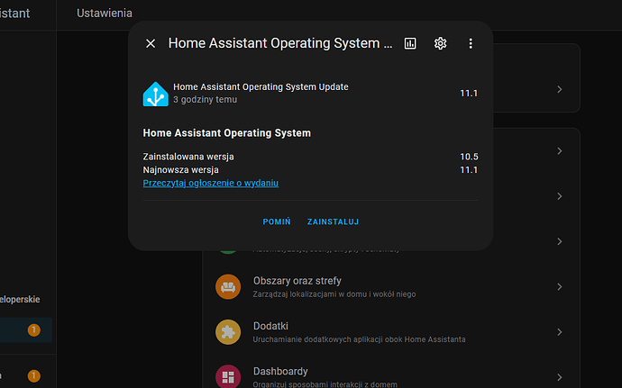

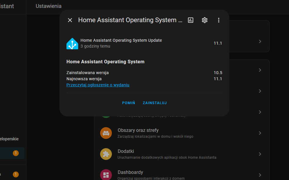

  • postanowiłem spróbować instalacji OS ver10,5 i to sie instaluje bez problemu HA wstaje natomiast ma błędy krytycze związane z brakiem supervisora i próba jego aktualizacji kończy się niepowodzeniem przez to nie da sie w HA nic zrobić (zainstalować żadnego dodatku). Zrobiłem tak dwie karty SD, na obu zachowanie identyczne.

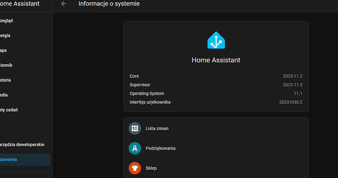

  • kolejne próby aktualizacji Supervisora - trudno powiedzieć czy się zainstalował ale chyba tak, natomiast aktualizacja systemu z ver 10,5 na 11,1 nie przechodzi tylko się po bardzo długim czasie zatrzymuje

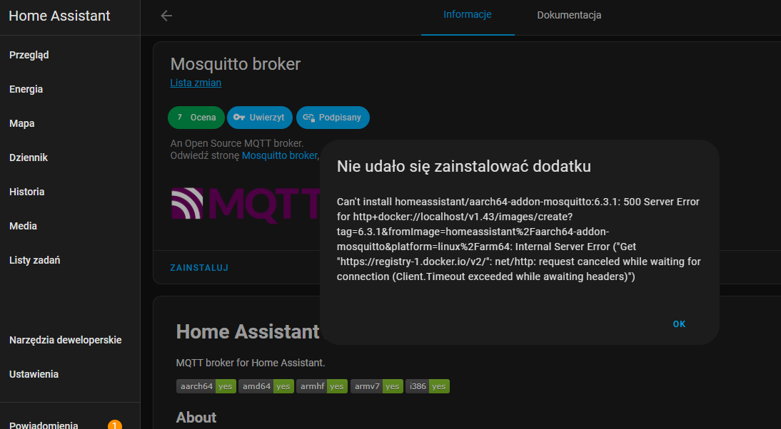

  • próba zainstalowania wtczki MQTT kończy się komunikatem: AddonManager.install’ blocked from execution, was unable to update plugin(s) cli and all plugins must be up to date first
    co by sugerowało konieczność aktualizacji systemu względem supervisora (tak domniemywam, nie znam się)

  • kolejna próba zainstalowania dodatku MQTT i taki komunikat:
    ## Nie udało się zainstalować dodatku
Can’t install homeassistant/aarch64-addon-mosquitto:6.3.1: 500 Server Error for http+docker://localhost/v1.43/images/create?tag=6.3.1&fromImage=homeassistant%2Faarch64-addon-mosquitto&platform=linux%2Farm64: Internal Server Error (“Get “https://registry-1.docker.io/v2/”: net/http: request canceled while waiting for connection (Client.Timeout exceeded while awaiting headers)”)

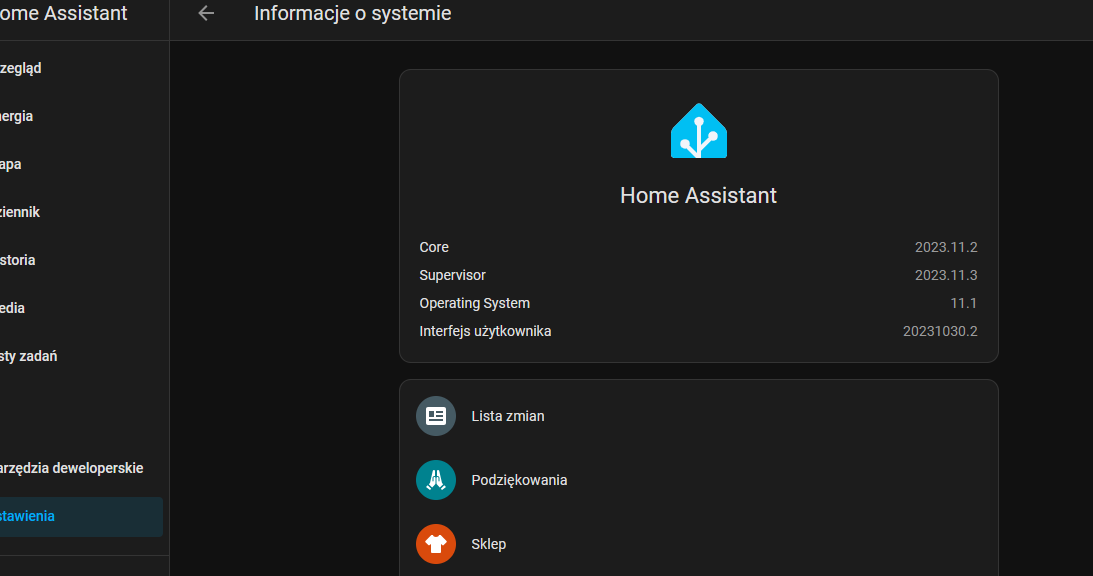

  • ale wygląda na to że system się wreszcie zaktualizował

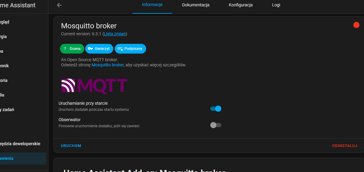

  • no i wreszcie i dodatek MQTT się zainstalował, więc wygląda na to że już będzie ok, winowajca problemów namierzony :stuck_out_tongue_winking_eye:
czyli wszystko wskazuje na to że problemem u mnie był/jest niestabilny transfer sieciowy, instalować trzeba do skutku aż załapie.
