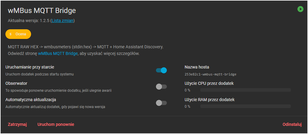

Home assistance:
[07:54:12] INFO: MQTT broker: core-mosquitto:1883
[07:54:12] INFO: Subscribing to: wmbus_bridge/sensor/wm-bus/raw
[07:54:12] INFO: Registering meters ...
[07:54:12] INFO: options.json:
[07:54:12] INFO: {"raw_topic":"wmbus_bridge/sensor/wm-bus/raw","meters":[{"id":"cold_water","meter_id":"55701281","type":"hydrodigit","mode":"T1"},{"id":"hot_water","meter_id":"55701849","type":"hydrodigit","mode":"T1"}]}
[07:54:12] INFO: Added /data/etc/wmbusmeters.d/meter-0001 (name=cold_water, driver=hydrodigit, id=55701281)
[07:54:12] INFO: Added /data/etc/wmbusmeters.d/meter-0002 (name=hot_water, driver=hydrodigit, id=55701849)
[07:54:12] INFO: Generated /data/etc/wmbusmeters.conf:
[07:54:12] INFO: [CONF] loglevel=normal
[07:54:12] INFO: [CONF] device=stdin:hex
[07:54:12] INFO: [CONF] logfile=/dev/stdout
[07:54:12] INFO: [CONF] format=json
[07:54:12] INFO: Meters directory: /data/etc/wmbusmeters.d
[07:54:12] INFO: total 16
[07:54:12] INFO: drwxr-xr-x    2 root     root          4096 Jan 28 07:54 .
[07:54:12] INFO: drwxr-xr-x    3 root     root          4096 Jan 27 18:04 ..
[07:54:12] INFO: -rw-r--r--    1 root     root            56 Jan 28 07:54 meter-0001
[07:54:12] INFO: -rw-r--r--    1 root     root            55 Jan 28 07:54 meter-0002
[07:54:12] INFO: Starting wmbusmeters...
Started config hextty on stdin listening on any
s6-rc: info: service legacy-services: stopping
services-up: info: copying legacy longrun wmbus_mqtt_bridge (no readiness notification)
[08:33:01] INFO: MQTT broker: core-mosquitto:1883
[08:33:01] INFO: Subscribing to: wmbus_bridge/sensor/wm-bus/raw
[08:33:01] INFO: wmbusmeters loglevel: debug
[08:33:01] INFO: filter_hex_only: true
[08:33:01] INFO: debug_every_n: 10
[08:33:01] INFO: options.json:
[08:33:01] INFO: {"raw_topic":"wmbus_bridge/sensor/wm-bus/raw","loglevel":"debug","filter_hex_only":true,"debug_every_n":10,"meters":[]}
[08:33:01] INFO: Registering meters ...
[08:33:01] WARNING: Brak meterów w konfiguracji -> TRYB NASŁUCHU.
[08:33:01] WARNING: Addon wypisze wykryte meter_id + gotowy snippet YAML do wklejenia.
[08:33:01] INFO: Generated /data/etc/wmbusmeters.conf:
[08:33:01] INFO: [CONF] loglevel=debug
[08:33:01] INFO: [CONF] device=stdin:hex
[08:33:01] INFO: [CONF] logfile=/dev/stdout
[08:33:01] INFO: [CONF] format=json
[08:33:01] INFO: Meters directory: /data/etc/wmbusmeters.d
[08:33:01] INFO: total 8
[08:33:01] INFO: drwxr-xr-x    2 root     root          4096 Jan 28 08:33 .
[08:33:01] INFO: drwxr-xr-x    3 root     root          4096 Jan 27 18:04 ..
[08:33:01] INFO: Starting wmbusmeters...

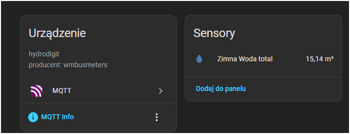

Jak zakończe to u siebie z powodzeniem to się podziele wynikiem.
Super pomysł widzę że już odczytuje datę i objętość, a i jeszcze to:

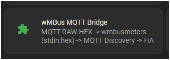

I chyba mi się udało…
[09:21:17] INFO: MQTT broker: core-mosquitto:1883
[09:21:17] INFO: Subscribing to: wmbus_bridge/telegram
[09:21:17] INFO: wmbusmeters loglevel: normal
[09:21:17] INFO: filter_hex_only: true
[09:21:17] INFO: debug_every_n: 0
[09:21:17] INFO: options.json:
[09:21:17] INFO: {"raw_topic":"wmbus_bridge/telegram","loglevel":"normal","filter_hex_only":true,"debug_every_n":0,"meters":[]}
[09:21:17] INFO: Registering meters ...
[09:21:17] WARNING: No meters configured -> LISTEN MODE.
[09:21:17] WARNING: Zostaw addon chwilę. W logach zobaczysz: 'Received telegram from: XXXXXXXX'.
[09:21:17] WARNING: To jest DLL-ID, które wpisujesz jako meter_id.
[09:21:17] INFO: Generated /data/etc/wmbusmeters.conf:
[09:21:17] INFO: [CONF] loglevel=normal
[09:21:17] INFO: [CONF] device=stdin:hex
[09:21:17] INFO: [CONF] logfile=/dev/stdout
[09:21:17] INFO: [CONF] format=json
[09:21:17] INFO: Meters directory: /data/etc/wmbusmeters.d
[09:21:17] INFO: total 8
[09:21:17] INFO: drwxr-xr-x    2 root     root          4096 Jan 28 08:33 .
[09:21:17] INFO: drwxr-xr-x    3 root     root          4096 Jan 27 18:04 ..
[09:21:17] INFO: Starting wmbusmeters...

Ja swoje znam. Puściłem dla testów co widzi Wmbusmeters po stronie HA

A po stronie HA stworzyłem Dodatek:
a w konsekwencji :

Nie nakłaniam absolutnie nikogo aby używać mój dodatek.
On powstał dokładnie dlatego bo napotkałem te same problemy które są opisywane w tym wątku.
Pomimo iż już Ci odpowiedziałem na Twoje pytanie musiałem poprosić GPT o analizę twojego kodu Gataway vs moje rozwiązanie.
U Ciebie ESP faktycznie emuluje dongla RTL-SDR i zachowuje model wejścia wmbusmeters.
U mnie podejście jest inne: nie symuluję sprzętu radiowego, tylko dostarczam wmbusmeters gotowe ramki wM-Bus jako dane logiczne.
To pozwala uruchomić wmbusmeters jako add-on Home Assistant bez USB/SDR i bez warstwy PHY, przy zachowaniu tego samego dekodera.
Bo zamiast symulować radio i ciągnąć warstwę sprzętową do HA, uprościłem architekturę: ESP dostarcza gotowe ramki protokołu, a ciężkie dekodowanie wykonuje wmbusmeters uruchomiony jako add-on Home Assistant.
Skąd można pobrać do testów Twój dodatek wmbus mqtt bridge?
