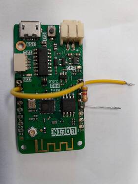

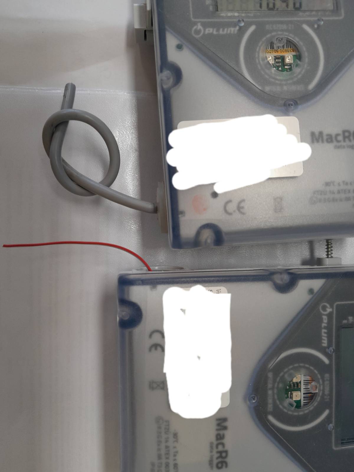

MacR6 podłączamy do tych wyjść:
A sam odbiornik jest banalnie prosty

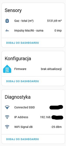

finalnie wychodzi coś takiego

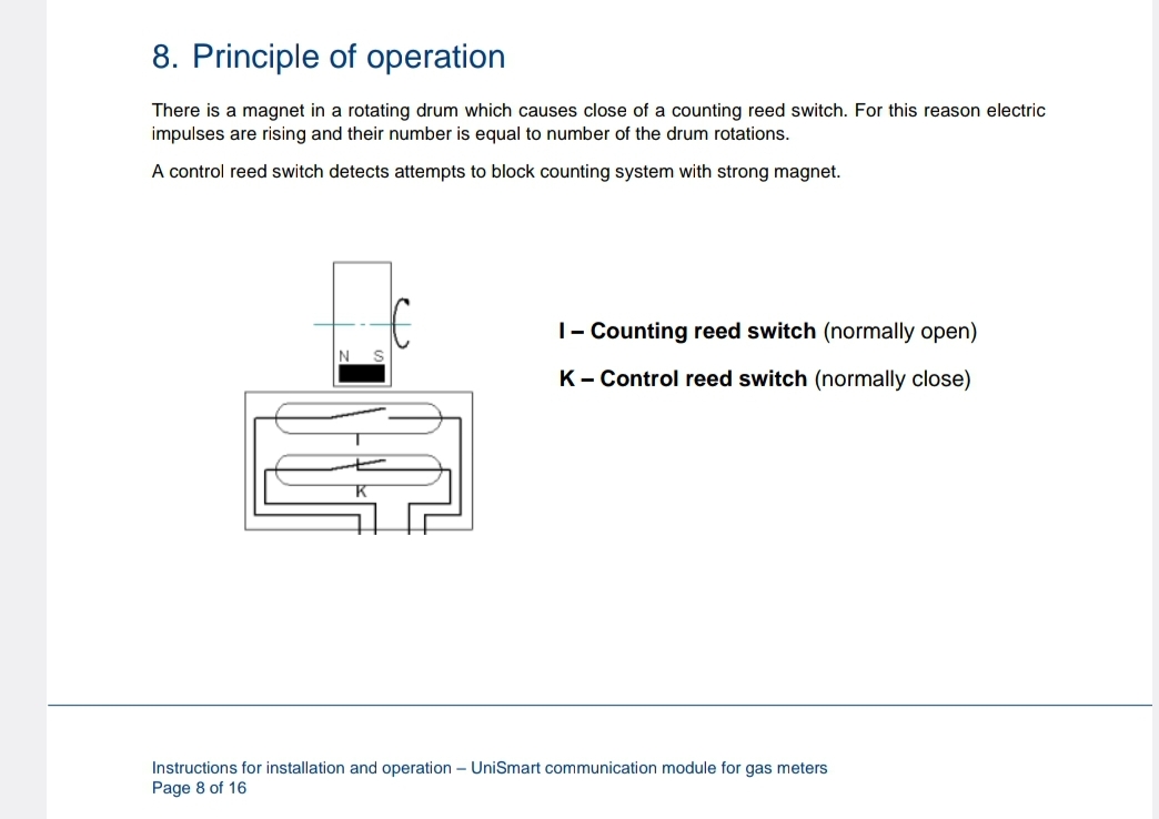

Did you mean by the previous post that you managed to use the pulse sensor connected to a MacR6? That should be a simple reed or double reed for detecting strong magnetic fields as well. Like it is inside the UniSmart.

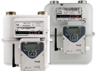

The problem is that the MacR6 installed on the gas meter uses the only available outputs to which the pulser can be connected.

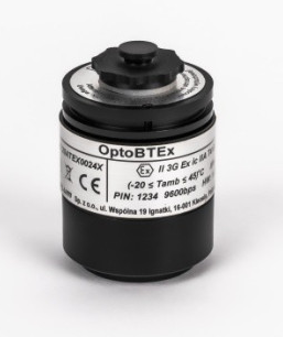

The impulse from the gas meter itself is too weak to be read by applying it to the counter. The MacR6 itself can also be read via the Opto-GAZ optical communication interface, e.g. via OptoBTEx connecting via Bluetooth.
In theory there is a second option. These gas meters should have a mirror which could be used with a light/IR pulse counter. (The magnet should have a reflective surface.)
