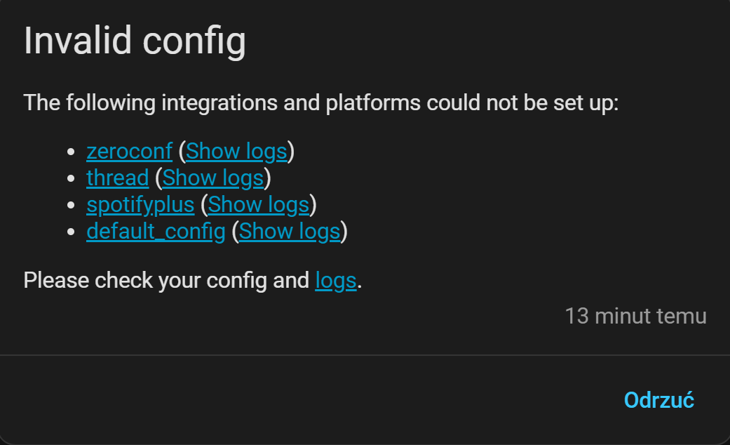

Witam,
po aktualizacji Home Assistant do wersji 2025.11 mam powiadomienia o błędach i potrzebuję Waszej pomocy.
Powiadomienie:
W logach to co poniżej.
Rejestrator: homeassistant.setup
Źródło: setup.py:425
Pierwsze zdarzenie: 15:05:03 (1 wystąpienie)
Ostatnio zalogowany: 15:05:03
Error during setup of component zeroconf: Invalid URL: port can't be converted to integer
  File "/usr/local/lib/python3.13/site-packages/yarl/_parse.py", line 134, in split_netloc
    port = int(port_str)
ValueError: invalid literal for int() with base 10: '8123:8123'
During handling of the above exception, another exception occurred:
  File "/usr/src/homeassistant/homeassistant/setup.py", line 425, in _async_setup_component
    result = await task
  File "/usr/src/homeassistant/homeassistant/components/zeroconf/__init__.py", line 193, in async_setup
    local_service_info = await _async_get_local_service_info(hass)
  File "/usr/src/homeassistant/homeassistant/components/zeroconf/__init__.py", line 299, in _async_get_local_service_info
    params["internal_url"] = get_url(hass, allow_external=False)
  File "/usr/src/homeassistant/homeassistant/helpers/network.py", line 150, in get_url
    return _get_internal_url(
        hass,
    ...<3 lines>...
        require_standard_port=require_standard_port,
  File "/usr/src/homeassistant/homeassistant/helpers/network.py", line 243, in _get_internal_url
    internal_url = yarl.URL(hass.config.internal_url)
  File "/usr/local/lib/python3.13/site-packages/yarl/_url.py", line 367, in __new__
    return pre_encoded_url(val) if encoded else encode_url(val)
  File "/usr/local/lib/python3.13/site-packages/yarl/_url.py", line 164, in encode_url
    username, password, host, port = split_netloc(netloc)
  File "/usr/local/lib/python3.13/site-packages/yarl/_parse.py", line 136, in split_netloc
    raise ValueError("Invalid URL: port can't be converted to integer")
ValueError: Invalid URL: port can't be converted to integer

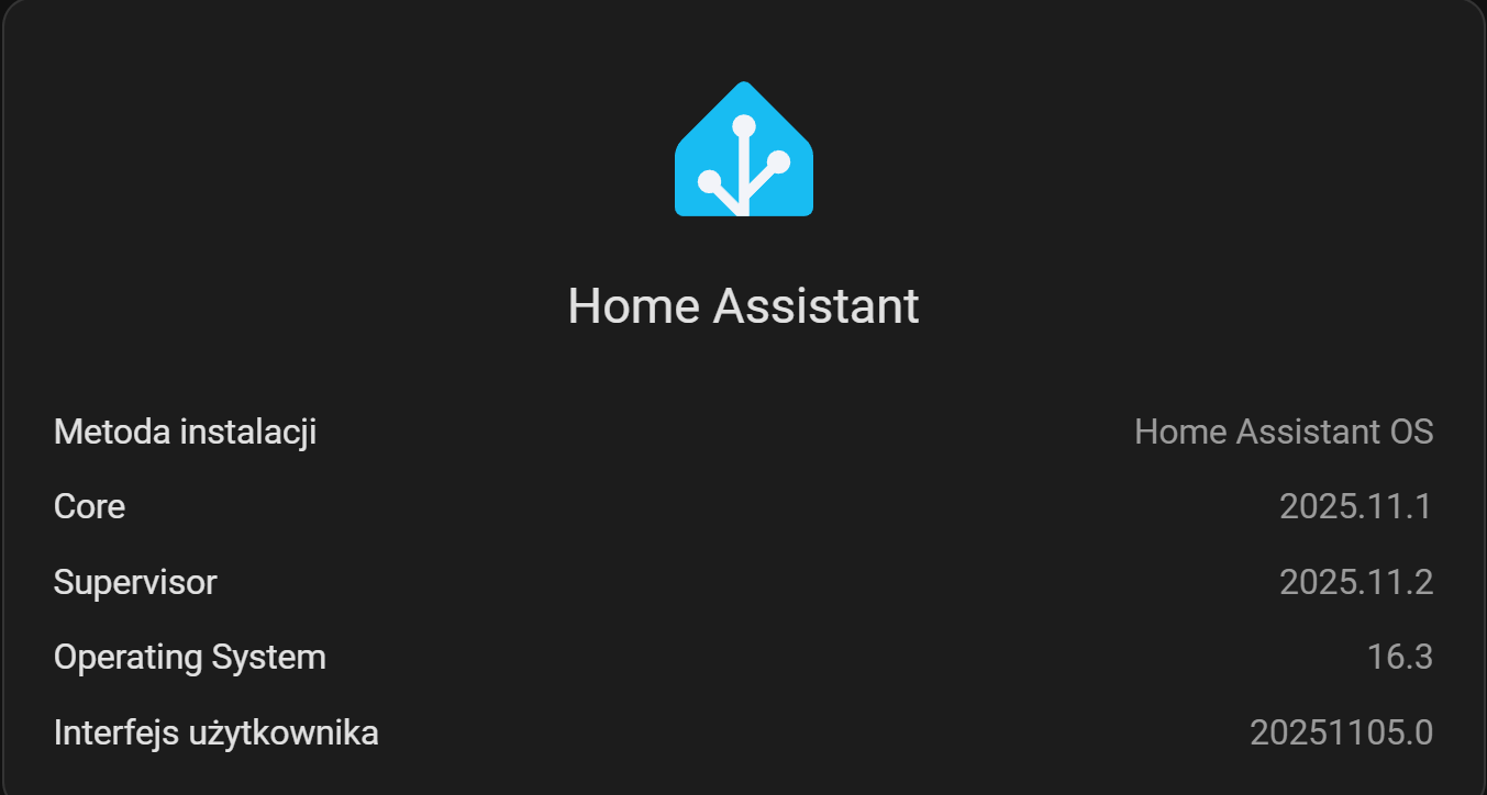

System postawiony na Rpi4

Odnośnie informacji o systemie:
System Information
version core-2025.10.4
dev false
hassio true
docker true
container_arch aarch64
user root
virtualenv false
python_version 3.13.7
os_name Linux
os_version 6.12.47-haos-raspi
arch aarch64
timezone Europe/Warsaw
config_dir /config
GitHub API ok
GitHub Content ok
GitHub Web ok
HACS Data ok
Installed Version 2.0.5
Stage running
Available Repositories 2379
Downloaded Repositories 114
Home Assistant Cloud
logged_in false
can_reach_cert_server ok
can_reach_cloud_auth ok
can_reach_cloud ok
GIOŚ
can_reach_server ok
Home Assistant Supervisor
host_os Home Assistant OS 16.3
update_channel stable
supervisor_version supervisor-2025.11.2
agent_version 1.7.2
docker_version 28.3.3
disk_total 116.7 GB
disk_used 35.1 GB
nameservers 192.168.0.1
healthy true
supported true
host_connectivity true
supervisor_connectivity true
ntp_synchronized true
virtualization
board rpi4-64
supervisor_api ok
version_api ok
installed_addons File editor (5.8.0), Music Assistant (BETA) (2.7.0b13), Mosquitto broker (6.5.2), Assist Microphone (1.3.0), Samba share (12.5.4), Fusion (2024.10.1), Whisper (3.0.1), Duck DNS (1.26.0), Studio Code Server (5.19.3), Node-RED (20.2.0), Advanced SSH & Web Terminal (22.0.0), Zigbee2MQTT (2.6.3-1), Matter Server (8.1.1), Home-Assistant-Matter-Hub (3.0.1), Music Assistant (2.6.2), MariaDB (2.7.2)

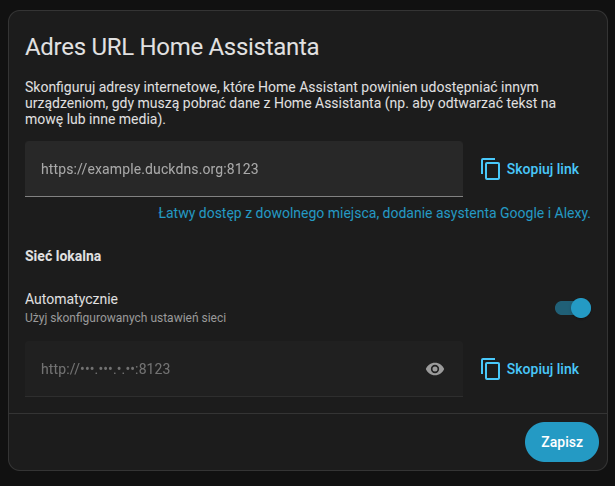

Myślałem, że coś w sekcji http masz podopisywane, bo log błędu wskazuje wyraźnie na zapis '8123:8123' jest niepoprawny (podany podwójne port)
Jeśli w YAML nic nie masz dopisane, to pozostaje sprawdzić w GUI.
Pokaż co masz w Ustawienia → System → Sieć
W ustawieniach połączenia kilka razy zmieniałem ostatnio.
2 warianty wprowadzałem.
https://mojadomena.duckdns.org:8123
bez podania adresu dostępu lokalnego bo przy tym ustawieniu nie da się wejść.
przestawiałem też na
http://mojadomena.duckdns.org:8123
i jako lokalny wpisywałem
http://192.168.0.202:8123 ( i tu się dostawałem lokalnie do HA w swojej sieci.
Kilka razy to zmieniałem.
Teraz też sprawdziłem oba ustawienia i na jednym i drugim ustawieniu ten błąd w logach tak samo występuje.
A próbowałeś to zmienić na http://mojadomena.duckdns.org (czyli niejawnie port 80) z przekierowaniem na lokalny adres na porcie 8123?
lub jeśli SSL (tu niejawnym domyślnym portem jest 443, który wymaga przekierowania)
https://mojadomena.duckdns.org → lokalny adres na porcie 8123?
Szczerze mówiąc polecam wykorzystać cloudflared zamiast kombinować z otwarciem pełnego nietunelowanego dostępu z zewnątrz.
Jeśli realnie potrzebujesz dostępu z zewnątrz w ten sposób (tj. tylko znikomy % integracji wymaga dostępu do HA od strony internetu), to cloudflared jest dobrym pomysłem (hint - domena .ovh to koszt poniżej 150zł na 10 lat, nie dokupuj żadnych dodatkowych opcji płatnych w stylu zbędnej poczty, która jest bodajże proponowana teraz przy zamawianiu domeny, a darmowa jest tylko na miesiąc, oczywiście można zrezygnować ze zbędnych płatnych usług nawet po zamówieniu jeśli zachowa się czujność, a potrzebna jest tylko domena).
Jeśli nie, i raczej myślisz o sporadycznym dostępie do sterowania od zewnątrz, to są 2 świetne i niemal bezkonfiguracyjne i wyjątkowo bezpieczne metody połączenia VPN tailscale zerotier (one w ogóle nie dają publicznego dostępu, jest on tylko w tej samej sieci VPN, a klienty są dostępne również na smartfony).
@szopen
dzięki za Twoją podpowiedź:
nie wiedziałem, że “tak” ale zastosowałem i działa . Ale docelowo cloudflared zdecydowanie do zainstalowania i konfigracji.
Na dziś powiem Wam @angler i @szopen , że odnośnie błędu w logach to po ustawieniu tak jak powyżej, wykasowaniu wszystkich tokenów by nowe zostały dodane na nowych adresach, wykasowaniu 95% błędów w logach, dalej mam:
Źródło: setup.py:623
Pierwsze zdarzenie: 19:01:28 (1 wystąpienie)
Ostatnio zalogowany: 19:01:28
Error handling when_setup callback for frontend
  File "/usr/src/homeassistant/homeassistant/setup.py", line 623, in when_setup
    await when_setup_cb(hass, component)
  File "/usr/src/homeassistant/homeassistant/components/zeroconf/__init__.py", line 210, in _async_zeroconf_hass_start
    await _async_register_hass_zc_service(hass, aio_zc, uuid)
  File "/usr/src/homeassistant/homeassistant/components/zeroconf/__init__.py", line 254, in _async_register_hass_zc_service
        hass,
    ...<3 lines>...
  File "/usr/local/lib/python3.13/site-packages/yarl/_url.py", line 358, in __new__
  File "/usr/local/lib/python3.13/site-packages/yarl/_url.py", line 155, in encode_url

Najbardziej przerażający był błąd odnośnie default_config, więc jeśli już go nie masz to jest już się z czego cieszyć.
A co do kwestii związanej z 8123, to podejrzewam, że chodzi o jakąś Integrację czegoś po sieci, może na bazie komponentu niestandardowego (tu głównym podejrzanym jest ten spotifyplus), podejrzewam, że gdzieś podałeś numer portu 8123 choć jest on akurat tam zbędny. Niestety musisz przejrzeć wszystko - na spółkę z należącym do HA configuration.yaml są też parsowane wszystkie inne pliki które w nim zawarłeś przez include (tak naprawdę ich treść należy do configuration.yaml, mimo, że jest przechowywana w innych plikach).
Błąd, który pokazujesz może dotyczy jakiegoś config flow - sprawdź czy HA nie wykrył czegoś nowego w sieci lub przypomnij sobie co konfigurowałeś w GUI i się nie udało, usuń wyłączone integracje i jeśli po restarcie HA zostaną ponownie wykryte nowe urządzenia w sieci albo je skonfiguruj poprawnie albo skutecznie zignoruj.
To może też być pozostałość w YAML jakiejś integracji, którą dzisiaj się konfiguruje w GUI, ale nie usunąłeś zbędnego obecnie YAMLa.
Zrób ha core rebuild i restart HA.
Przez kilka dni robiłem przegląd w mojej intalacji HA, cały czas szukając
rozwiązania problemu z błedem w logach.
Uczepiłem się tego “8123:8123” i powtarzającego się " Invalid URL" które wg mnie wskazywały na błąd w bliżej nie określonej konfiguracji dostępu do HA.
Gdzieś coś mi dzwoniło ale nie mogłem sobie przypomieć.
Ale przypomniałem sobie wreszcie, że kiedyś w configuration.yaml miałem jakiś wpis który by sie jakoś z tym pokrywał. Pogrzebałem, poszukałem i znalazłem taki wpis:
  external_url: "https://xxxxxxxxxxx.duckdns.org:8123"
  internal_url: "https://192.168.0.202:8123"
wykasowany z mojego configuration.yaml miesiące temu.
Dodałem do obecnego configuration.yaml, restart i … z tym wpisem błąd się nie pojawił w logach.
Zrestartowałem jeszcze raz dla pewności i dalej bez błedu w logach.
Dalej - kopia zapasowa i instalacja HA 2025.11.2 - restart i żadnych powiadomień ,Invalid config".
Podsumowanie ( żeby @szopen znów nie powiedział, że nie podsumowałem :wink:) jest takie, że znalazłem rozwiązanie, dzielę się nim ze Wszystkimi na Forum ( może komuś, kiedyś oszczędzi nerwy i czas).
Wszystko działa.
Do zamknięcia… jednak chyba nie .
Muszę coś jeszcze posprawdzać , bo właśnie zauważyłem dlaczego ten wpis kiedyś usunąłem z configuration.yaml
ech… a mogło być tak pięknie.
Takiej konstrukcji raczej nie może być, bo nie wiem jak wykombinujesz dla IP działający certyfikat,
ale to raczej już powinno działać
internal_url: "http://192.168.0.202:8123"
tylko szczerze mówiąc taką konstrukcję to bym wywalił z YAMLa, bo zarówno adres “wewnętrzny”/“LANowski” jak i “WANowski”/“zewnętrzny” teraz konfiguruje się w GUI, w dodatku “wewnętrzny” ma opcję autokonfiguracji (więc nie tworzy konfliktów jak zła konfiguracja w YAMLu).
No właśnie dlatego kiedyś to usunąłem z YAMLa i wszystko działało dobrze do wersji 2025.10.4. w wersji 2025.11 wywala ten ,invalid config’ i w System - Sieć - Przeglądarka Zeroconf nie ma żadnego wpisu.
A jak wpiszę te external i internal to na wersji Listopadowej nie mam błędów i w System - Sieć - Przeglądarka Zeroconf są wszystkie wpisy. iIntegracje wszystkie się ładują.
Gdzieś jest coś skopane z konfiguracją (może jakaś jedna kropka czy inny wuj) … tak myślę.
Nie mam pojęcia co z tym zrobić. Stawianie wszystkiego od zera wcale mi się nie uśmiecha.
Jeszcze jedna rzecz. Jak nie mam wpisu w YAMLu to w Ustawienia - System - Sieć nie mam w ogóle tego okna gdzie można wpisać adres zewnętrzny i wewnętrzny Home Assistanta.
Brzmi bardzo niepokojąco, ale nie mam pomysłu, poza jedną kwestią - przy zmianie ustawień dotyczących hosta sam restart HA nie jest wystarczający do załadowania nowej konfiguracji - w takich wypadkach obowiązkowy jest restart całego OSa.
