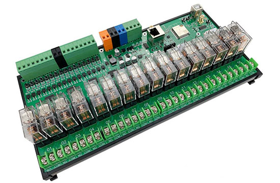

Trochę słabo, że ich forum nie jest dostosowane do wklejania kodu… i YAML zawiera śmieciowe tylne apostrofy na początku i końcu, po poprawce jest taki
  platform: ESP32
  board: esp32dev
  platformio_options:
    board_build.extra_flags:
      # WIFI_CONTROL_SELF_MODE = 0
      # WIFI_CONTROL_SELF_MODE = 1
      - "-DWIFI_CONTROL_SELF_MODE=0"
external_components:
  - source:
      type: git
      url: https://github.com/hzkincony/esphome-tuya-wifi-mcu
      ref: v1.1.0
uart:
  tx_pin: 33
  rx_pin: 14
  baud_rate: 9600
tuya_wifi_mcu:
  # tuya mcu product id
  product_id: tfj1dtlneyxp5uya
  uart_id: tuya_mcu_uart
  wifi_reset_pin: 5
  wifi_led_pin: 12
# Example configuration entry for ESP32
i2c:
  sda: 16
  scl: 15
  scan: true
ethernet:
  type: LAN8720
  mdc_pin: GPIO23
  mdio_pin: GPIO18
  clk_mode: GPIO17_OUT
  phy_addr: 0
pcf8574:
  - id: 'pcf8574_hub_out_1'  # for output channel 1-8
    address: 0x21
  - id: 'pcf8574_hub_out_2'  # for output channel 9-16
    address: 0x25
  - id: 'pcf8574_hub_in_1'  # for input channel 1-8
    address: 0x22
  - id: 'pcf8574_hub_in_2'  # for input channel 9-16
    address: 0x24
# Individual outputs
switch:
  - platform: gpio
    pin:
      pcf8574: pcf8574_hub_out_1
      number: 0
      mode: OUTPUT
      inverted: true
  - platform: tuya_wifi_mcu
    dp_id: 1
    # hide from homeassistant ui
    internal: true
    # bind other switch, sync state
    bind_switch_id: "e16t_output1"
  - platform: gpio
    pin:
      number: 1
      mode: OUTPUT
      inverted: true
    dp_id: 2
    internal: true
    bind_switch_id: "e16t_output2"
  - platform: gpio
    pin:
      number: 2
      mode: OUTPUT
      inverted: true
    dp_id: 3
    internal: true
    bind_switch_id: "e16t_output3"
  - platform: gpio
    pin:
      number: 3
      mode: OUTPUT
      inverted: true
    dp_id: 4
    internal: true
    bind_switch_id: "e16t_output4"
  - platform: gpio
    pin:
      number: 4
      mode: OUTPUT
      inverted: true
    dp_id: 5
    internal: true
    bind_switch_id: "e16t_output5"
  - platform: gpio
    pin:
      number: 5
      mode: OUTPUT
      inverted: true
    dp_id: 6
    internal: true
    bind_switch_id: "e16t_output6"
  - platform: gpio
    pin:
      number: 6
      mode: OUTPUT
      inverted: true
    dp_id: 101
    internal: true
    bind_switch_id: "e16t_output7"
  - platform: gpio
    pin:
      number: 7
      mode: OUTPUT
      inverted: true
    dp_id: 102
    internal: true
    bind_switch_id: "e16t_output8"
  - platform: gpio
    pin:
      pcf8574: pcf8574_hub_out_2
      number: 0
      mode: OUTPUT
      inverted: true
    dp_id: 103
    internal: true
    bind_switch_id: "e16t_output9"
  - platform: gpio
    pin:
      number: 1
      mode: OUTPUT
      inverted: true
    dp_id: 104
    internal: true
    bind_switch_id: "e16t_output10"
  - platform: gpio
    pin:
      number: 2
      mode: OUTPUT
      inverted: true
    dp_id: 105
    internal: true
    bind_switch_id: "e16t_output11"
  - platform: gpio
    pin:
      number: 3
      mode: OUTPUT
      inverted: true
    dp_id: 106
    internal: true
    bind_switch_id: "e16t_output12"
  - platform: gpio
    pin:
      number: 4
      mode: OUTPUT
      inverted: true
    dp_id: 107
    internal: true
    bind_switch_id: "e16t_output13"
  - platform: gpio
    pin:
      number: 5
      mode: OUTPUT
      inverted: true
    dp_id: 108
    internal: true
    bind_switch_id: "e16t_output14"
  - platform: gpio
    pin:
      number: 6
      mode: OUTPUT
      inverted: true
    dp_id: 109
    internal: true
    bind_switch_id: "e16t_output15"
  - platform: gpio
    pin:
      number: 7
      mode: OUTPUT
      inverted: true
    dp_id: 110
    internal: true
    bind_switch_id: "e16t_output16"
binary_sensor:
  - platform: gpio
    pin:
      pcf8574: pcf8574_hub_in_1
      number: 0
      mode: INPUT
      inverted: true
    name: e16t DI01 Tuya
    dp_id: 111
    bind_binary_sensor_id: e16t_input1
    internal: true
  - platform: gpio
    pin:
      number: 1
      mode: INPUT
      inverted: true
    name: e16t DI02 Tuya
    dp_id: 112
    bind_binary_sensor_id: e16t_input2
    internal: true
  - platform: gpio
    pin:
      number: 2
      mode: INPUT
      inverted: true
    name: e16t DI03 Tuya
    dp_id: 113
    bind_binary_sensor_id: e16t_input3
    internal: true
  - platform: gpio
    pin:
      number: 3
      mode: INPUT
      inverted: true
    name: e16t DI04 Tuya
    dp_id: 114
    bind_binary_sensor_id: e16t_input4
    internal: true
  - platform: gpio
    pin:
      number: 4
      mode: INPUT
      inverted: true
    name: e16t DI05 Tuya
    dp_id: 115
    bind_binary_sensor_id: e16t_input5
    internal: true
  - platform: gpio
    pin:
      number: 5
      mode: INPUT
      inverted: true
    name: e16t DI06 Tuya
    dp_id: 116
    bind_binary_sensor_id: e16t_input6
    internal: true
  - platform: gpio
    pin:
      number: 6
      mode: INPUT
      inverted: true
    name: e16t DI07 Tuya
    dp_id: 117
    bind_binary_sensor_id: e16t_input7
    internal: true
  - platform: gpio
    pin:
      number: 7
      mode: INPUT
      inverted: true
    name: e16t DI08 Tuya
    dp_id: 118
    bind_binary_sensor_id: e16t_input8
    internal: true
  - platform: gpio
    pin:
      pcf8574: pcf8574_hub_in_2
      number: 0
      mode: INPUT
      inverted: true
    name: e16t DI09 Tuya
    dp_id: 119
    bind_binary_sensor_id: e16t_input9
    internal: true
  - platform: gpio
    pin:
      number: 1
      mode: INPUT
      inverted: true
    name: e16t DI10 Tuya
    dp_id: 120
    bind_binary_sensor_id: e16t_input10
    internal: true
  - platform: gpio
    pin:
      number: 2
      mode: INPUT
      inverted: true
    name: e16t DI11 Tuya
    dp_id: 121
    bind_binary_sensor_id: e16t_input11
    internal: true
  - platform: gpio
    pin:
      number: 3
      mode: INPUT
      inverted: true
    name: e16t DI12 Tuya
    dp_id: 122
    bind_binary_sensor_id: e16t_input12
    internal: true
  - platform: gpio
    pin:
      number: 4
      mode: INPUT
      inverted: true
    name: e16t DI13 Tuya
    dp_id: 123
    bind_binary_sensor_id: e16t_input13
    internal: true
  - platform: gpio

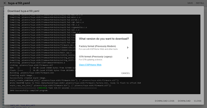

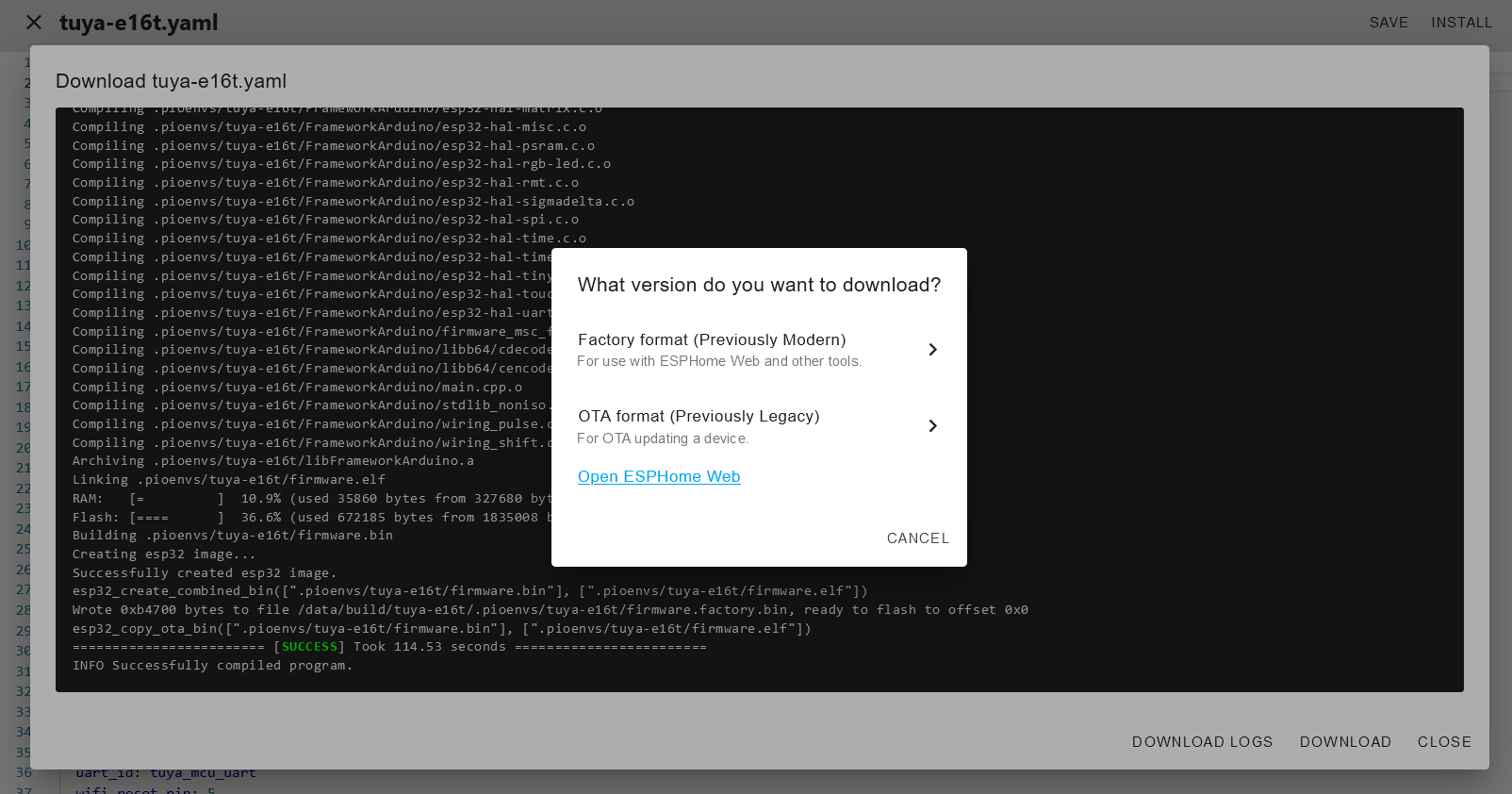

wkrótce sprawdzę czy jest to zdatne do kompilacji zrobione
ten też jest bezproblemowy w kompilacji
Niżej trochę zmodyfikowany YAML (bo nie podoba mi się totalny burdel w kolejności komponentów funkcjonalnych w tym YAMLu, nie sprzątałęm tego jakoś intensywnie, ale tak by się lepiej czytało), nazwę też zmieniłem żeby podkreślała, że tam jest użyty moduł Tuya, no i by nie kompilować w tym samym katalogu, gdzie masz pewnie śmietnik, dołożona też OTA (to będzie koniec z flaszowaniem przez USB, jeśli to odpali na sprzęcie i nie spaprzesz YAMLa robiąc w nim modyfikacje pod swoje potrzeby).
  platform: ESP32
  board: esp32dev
  platformio_options:
# Enable logging
# Enable Home Assistant API NO password!
# OTA NO password!
  platform: esphome
  password: ""
web_server:
  port: 80
  - source:
      type: git
      ref: v1.1.0
uart:
  tx_pin: 33
  rx_pin: 14
  baud_rate: 9600
tuya_wifi_mcu:
  wifi_reset_pin: 5
  wifi_led_pin: 12
i2c:
  sda: 16
  scl: 15
  scan: true
ethernet:
  type: LAN8720
  mdc_pin: GPIO23
  mdio_pin: GPIO18
  phy_addr: 0
pcf8574:
    address: 0x21
    address: 0x25
    address: 0x22
    address: 0x24
switch:
  - platform: gpio
    pin:
      number: 0
      mode: OUTPUT
      inverted: true
    dp_id: 1
    internal: true
  - platform: gpio
    pin:
      number: 1
      mode: OUTPUT
      inverted: true
    dp_id: 2
    internal: true
  - platform: gpio
    pin:
      number: 2
      mode: OUTPUT
      inverted: true
    dp_id: 3
    internal: true
  - platform: gpio
    pin:
      number: 3
      mode: OUTPUT
      inverted: true
    dp_id: 4
    internal: true
  - platform: gpio
    pin:
      number: 4
      mode: OUTPUT
      inverted: true
    dp_id: 5
    internal: true
  - platform: gpio
    pin:
      number: 5
      mode: OUTPUT
      inverted: true
    dp_id: 6
    internal: true
  - platform: gpio
    pin:
      number: 6
      mode: OUTPUT
      inverted: true
    dp_id: 101
    internal: true
  - platform: gpio
    pin:
      number: 7
      mode: OUTPUT
      inverted: true
    dp_id: 102
    internal: true
  - platform: gpio
    pin:
      number: 0
      mode: OUTPUT
      inverted: true
    dp_id: 103
    internal: true
  - platform: gpio
    pin:
      number: 1
      mode: OUTPUT
      inverted: true
    dp_id: 104
    internal: true
  - platform: gpio
    pin:
      number: 2
      mode: OUTPUT
      inverted: true
    dp_id: 105
    internal: true
  - platform: gpio
    pin:
      number: 3
      mode: OUTPUT
      inverted: true
    dp_id: 106
    internal: true
  - platform: gpio
    pin:
      number: 4
      mode: OUTPUT
      inverted: true
    dp_id: 107
    internal: true
  - platform: gpio
    pin:
      number: 5
      mode: OUTPUT
      inverted: true
    dp_id: 108
    internal: true
  - platform: gpio
    pin:
      number: 6
      mode: OUTPUT
      inverted: true
    dp_id: 109
    internal: true
  - platform: gpio
    pin:
      number: 7
      mode: OUTPUT
      inverted: true
    dp_id: 110
    internal: true
binary_sensor:
  - platform: gpio
    pin:
      number: 0
      mode: INPUT
      inverted: true
    dp_id: 111
    internal: true
  - platform: gpio
    pin:
      number: 1
      mode: INPUT
      inverted: true
    dp_id: 112
    internal: true
  - platform: gpio
    pin:
      number: 2
      mode: INPUT
      inverted: true
    dp_id: 113
    internal: true
  - platform: gpio
    pin:
      number: 3
      mode: INPUT
      inverted: true
    dp_id: 114
    internal: true
  - platform: gpio
    pin:
      number: 4
      mode: INPUT
      inverted: true
    dp_id: 115
    internal: true
  - platform: gpio
    pin:
      number: 5
      mode: INPUT
      inverted: true
    dp_id: 116
    internal: true
  - platform: gpio
    pin:
      number: 6
      mode: INPUT
      inverted: true
    dp_id: 117
    internal: true
  - platform: gpio
    pin:
      number: 7
      mode: INPUT
      inverted: true
    dp_id: 118
    internal: true
  - platform: gpio
    pin:
      number: 0
      mode: INPUT
      inverted: true
    dp_id: 119
    internal: true
  - platform: gpio
    pin:
      number: 1
      mode: INPUT
      inverted: true
    dp_id: 120
    internal: true
  - platform: gpio
    pin:
      number: 2
      mode: INPUT
      inverted: true
    dp_id: 121
    internal: true
  - platform: gpio
    pin:
      number: 3
      mode: INPUT
      inverted: true
    dp_id: 122
    internal: true
  - platform: gpio
    pin:
      number: 4
      mode: INPUT
      inverted: true
    dp_id: 123
    internal: true
  - platform: gpio
    pin:
      number: 5
      mode: INPUT
      inverted: true
    name: e16t DI14 Tuya
    dp_id: 124
    bind_binary_sensor_id: e16t_input14
    internal: true
  - platform: gpio
    pin:
      number: 6
      mode: INPUT
      inverted: true
    name: e16t DI15 Tuya
    dp_id: 125
    bind_binary_sensor_id: e16t_input15
    internal: true
  - platform: gpio
    pin:
      number: 7
      mode: INPUT
      inverted: true
    name: e16t DI16 Tuya
    dp_id: 126
    bind_binary_sensor_id: e16t_input16
    internal: true
  - platform: sht3xd
    temperature:
    humidity:
    address: 0x44
    update_interval: 5s

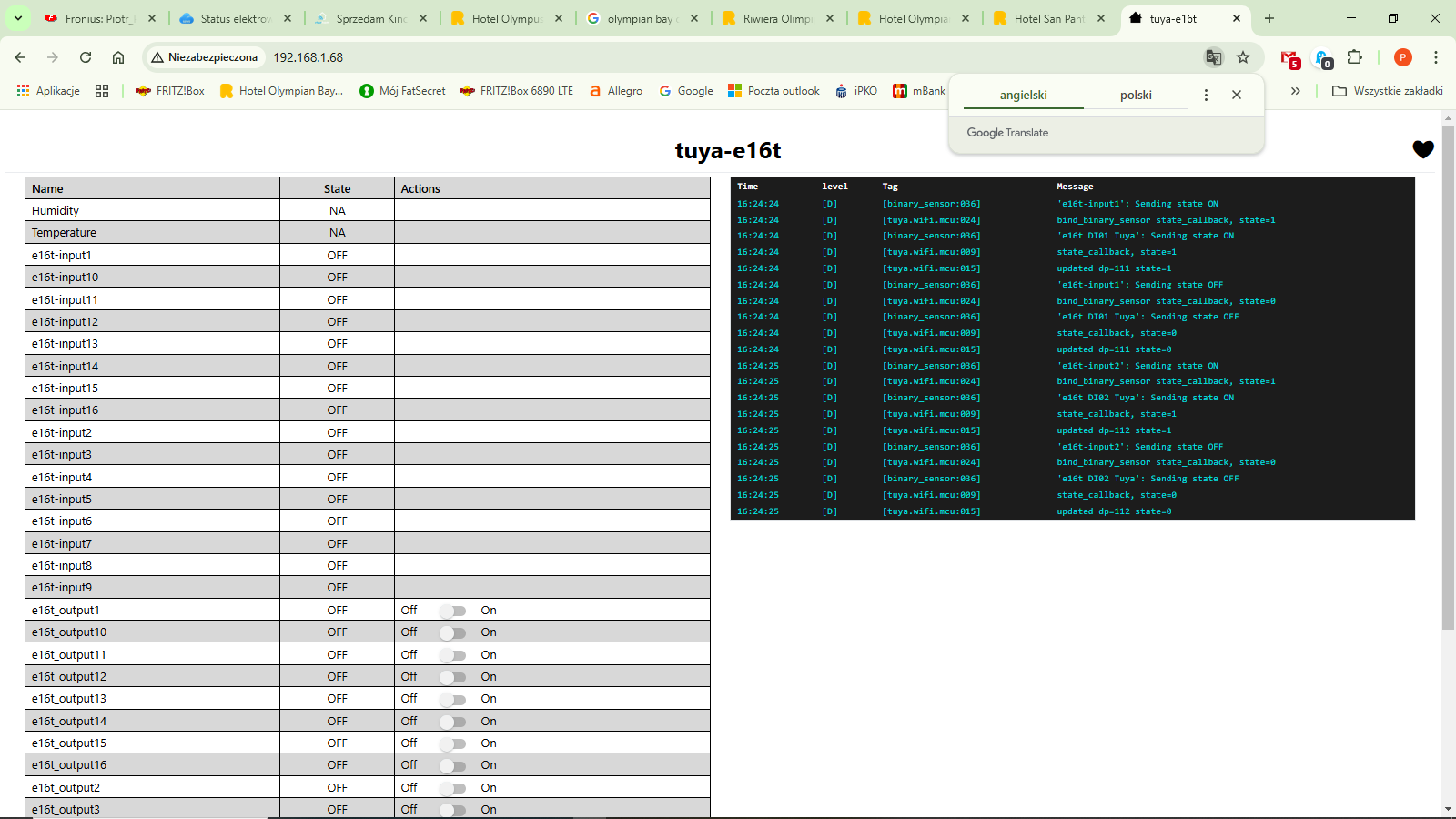

w załączniku bin factory
tuya-e16t.factory.zip (400,2 KB)
skompilowany z powyższego YAMLa (do wgrania np. tędy, oczywiście przez USB, ale miejmy nadzieję, że ostatni raz)
https://web.esphome.io
web-flasher ^ wymaga przeglądarki z obsługą web-serial, czyli np. chrome lub edge (ewentualnie stara wersja Vivaldi = co najwyżej 6.9.3447.54 bo wszystkie nowsze jakie widziałem mają błąd, a już cierpliwość mi się skończyła z czekaniem na naprawę i testowaniem kolejnych niedziałąjących poprawnie)
web-flasher NIE działa w większości pozostałych przeglądarek (safari, firefox, opera itd.), istnieją inne narzędzia, jednak to jest tak wygodne, że warte zainstalowania przeglądarki z web-serial.

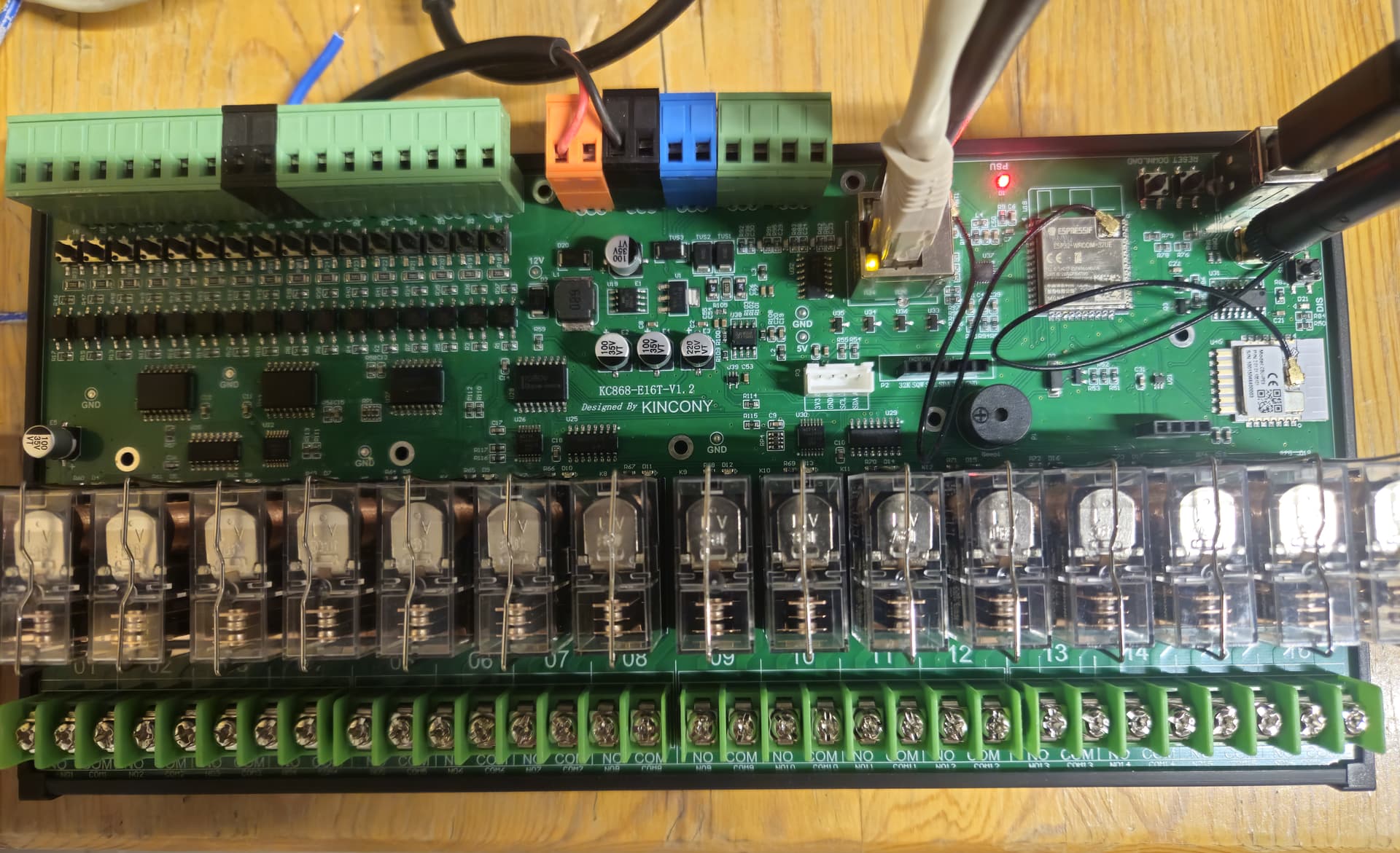

ale zdjęć się nie doczekałem…
ani odpowiedzi na pozostałe pytania (gdzie jest bryk z konfiguracji instalacji HA i informacje o sprzęcie na którym to kompilujesz, bo radośnie zakładam, że to dodatek, a nie samodzielna instalacja, jesli samodzielna to także informacje o maszynie na której kompilujesz)
edit (parę godzin później, na miarę mojego wolnego czasu)

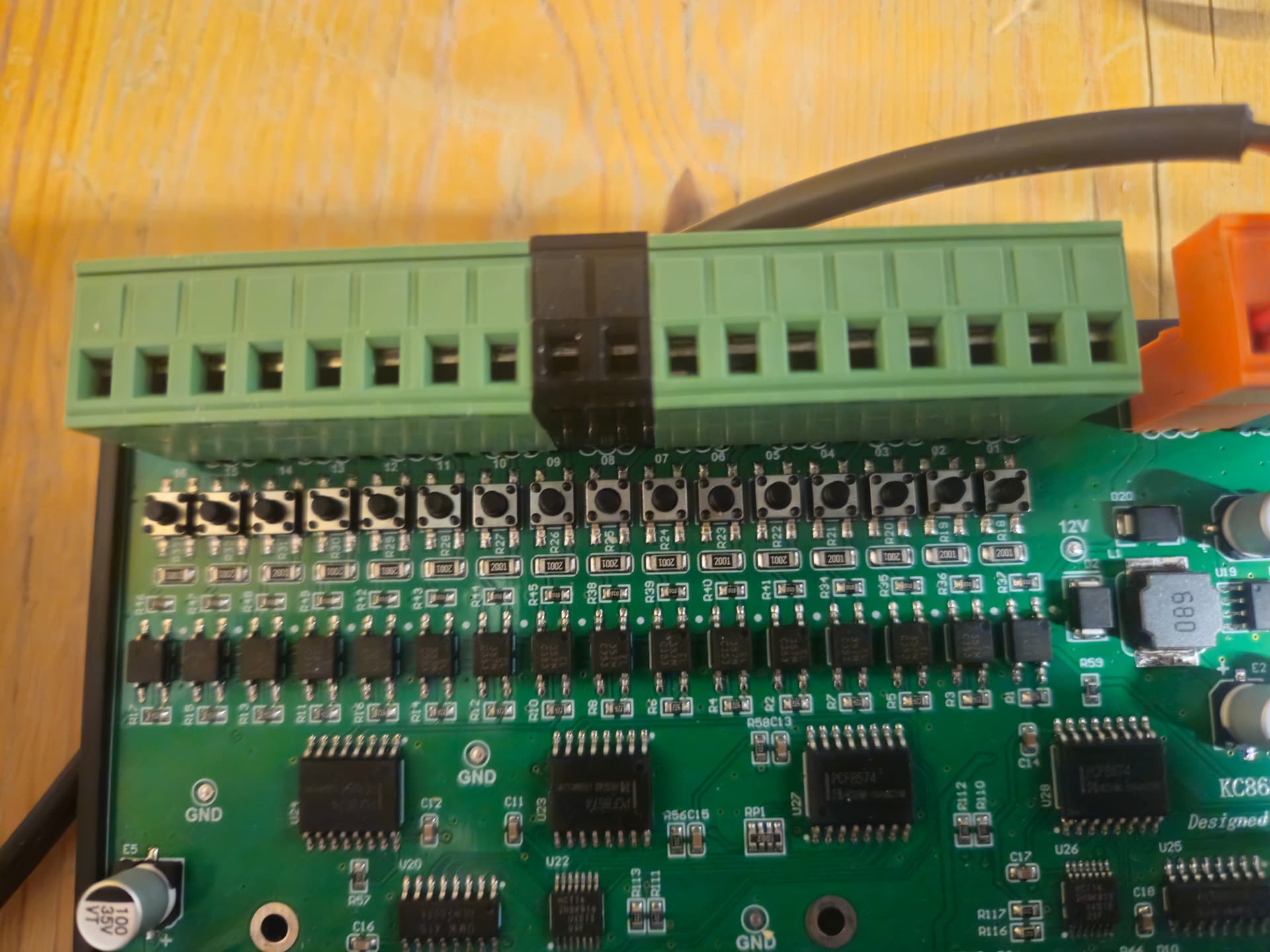

Zajrzałem też do kodu, który przeoczyłem wcześniej, bo wcisnąłeś do załacznika zamiast wstawić kod jako kod… i… wygląda normalnie.
Moim zdaniem powinien się kompilować i działać normalnie (tak samo normalnie jak ten od Chińczyka), tylko to nie jest kompletny kod - brak w nim jakiejkolwiek automatyki.
Ciekawe jak sprawdziłeś wejścia, że nabrałeś przekonania o tym, że nie działąją… (obserwowałeś logi lub statusy sensorów binarnych? bo przeciez przyciski w tych YAMLach nie są powiązane programowo z przekaźnikami w żaden sposób).
Taki hint - bo dalej zdjęć się nie doczekałem - przy wciskaniu przycisków (jeszcze nie) sterujących powinny się zapalać na czas wciśnięcia przyporządkowane im diodki LED na płycie głównej, jeśli tak się nie dzieje to spaprany jest ukłąd wejściowy (sprzęt nadaje się do zwrotu jeśli nie jest sprawny, a nie do odsprzedaży).
